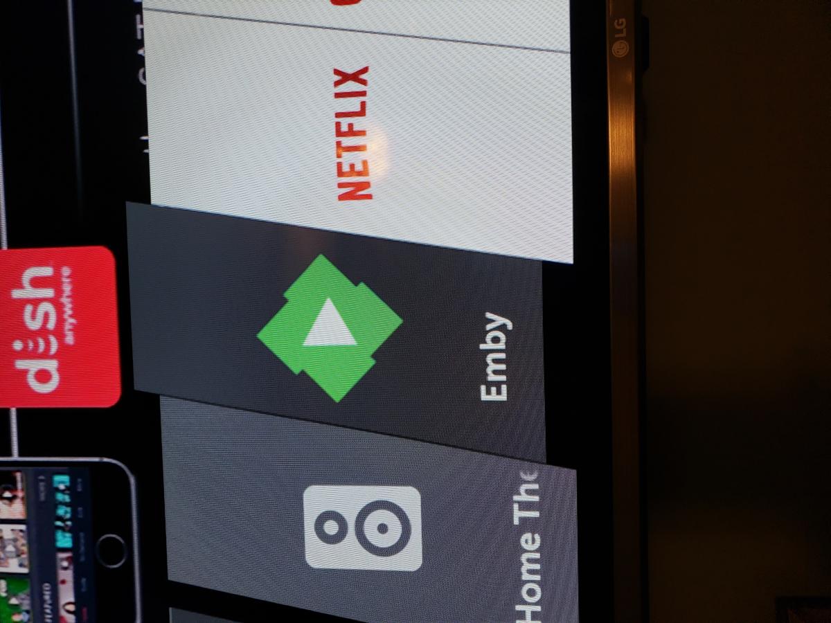

Misinthe 46 Posted May 30, 2019 Author Posted May 30, 2019 Hi there, how are you trying to connect? I am using the native app for LG smart TVs. Here are some pictures.
