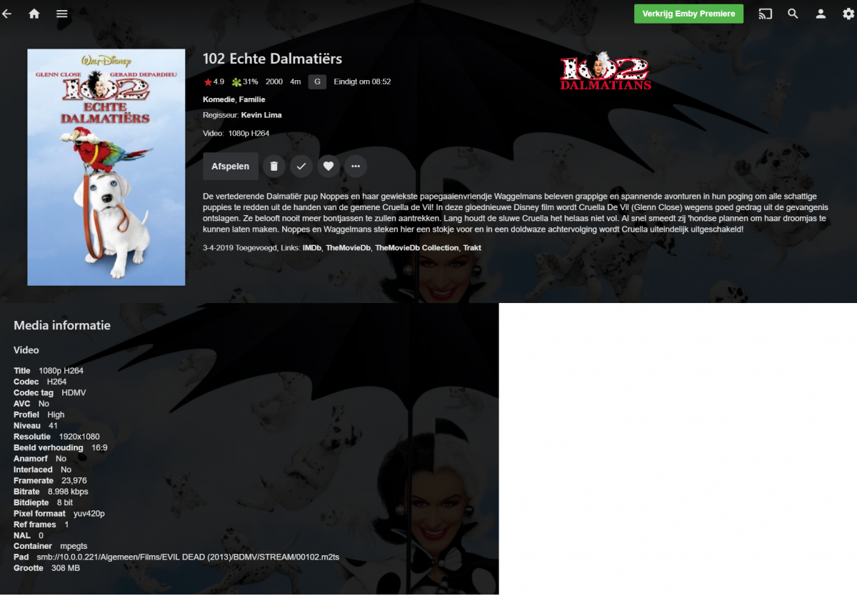

jasonborn 21 Posted May 29, 2019 Posted May 29, 2019 (edited) Good morning, I have the same issue on/with my fresh installed Emby on Pi 3b+. The series are scanned almost perfect, but the scrape of my movies with fifferent formats, are a bit of a mess. Any ideas? Kind regards, ps: also attached a screenshot from what I see in Emby; a m2ts file (evil dead) is scaped as '102 echte Dalmatiers' Emby Logging.txt Edited May 29, 2019 by jasonborn 1
jasonborn 21 Posted May 29, 2019 Posted May 29, 2019 Hmm, I created a new library without full Blu-ray and scraping is going fine. If I add a full BD, than scraping of the BD goes wrong. Structure: \\NAS\Volume1\Algemeen\EVIL DEAD (2013)\BDMV Let's erperiment a little bit more. 1

jasonborn 21 Posted May 31, 2019 Posted May 31, 2019 After experimenting a little bit, here's my solution: Scraping BDMV with multiple M2TS files and Video_TS with multiple files is not working in my case. In case of full blu-ray's I deleted all the M2TS files except the largest on. In case of Video_TS I converted them to MKV. After that, scraping works like a charm. Kind regards,
