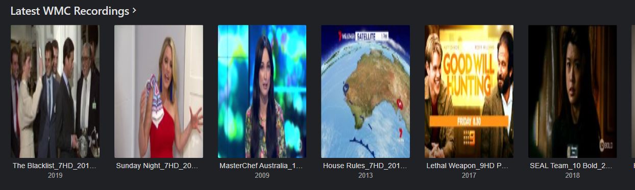

rliepins 9 Posted May 12, 2019 Author Posted May 12, 2019 Yes, as a separate library. But the point is consolidation. Can I add the WMC Recorded TV folder to the Emby Recordings folder, even without a folder structure? Emby sorts the recordings in series and season folders but WMC keeps its recordings in a flat directory. Sent from my iPhone using Tapatalk
Luke 42245 Posted May 13, 2019 Posted May 13, 2019 It would need to follow supported tv naming conventions: https://github.com/MediaBrowser/Wiki/wiki/TV-naming
denz 501 Posted May 13, 2019 Posted May 13, 2019 It has to be a different library for some reason emby is treating everything as a movie I would prefer that it doesn't so we have landscape thumbnail. Looking at the screen caps just about everything is an advert. I don't think there is a way to import schedule as you would first have to export the schedule and I certainly haven't seen an option for that in WMC as why would they. For not recording did you refresh the guide I am doing a lot of test recordings and trying to move my family slowly over to Android TV is so far the best client to replace WMC it is not there yet but it is close. Emby is lacking in conflicts but I purchased a new hdhomerun so it is not an issue any more. To help with not recording post screenshots of the series recording it is usually the result of incorrect guide data wmc looks at other tags not just is it a repeat or not whereas emby may not that is what I found out when some of the recordings didn't record but it is best to create a new post for that issue.
Luke 42245 Posted May 13, 2019 Posted May 13, 2019 for some reason emby is treating everything as a movie It's due to what I said in my previous post about supported TV folder structures.
