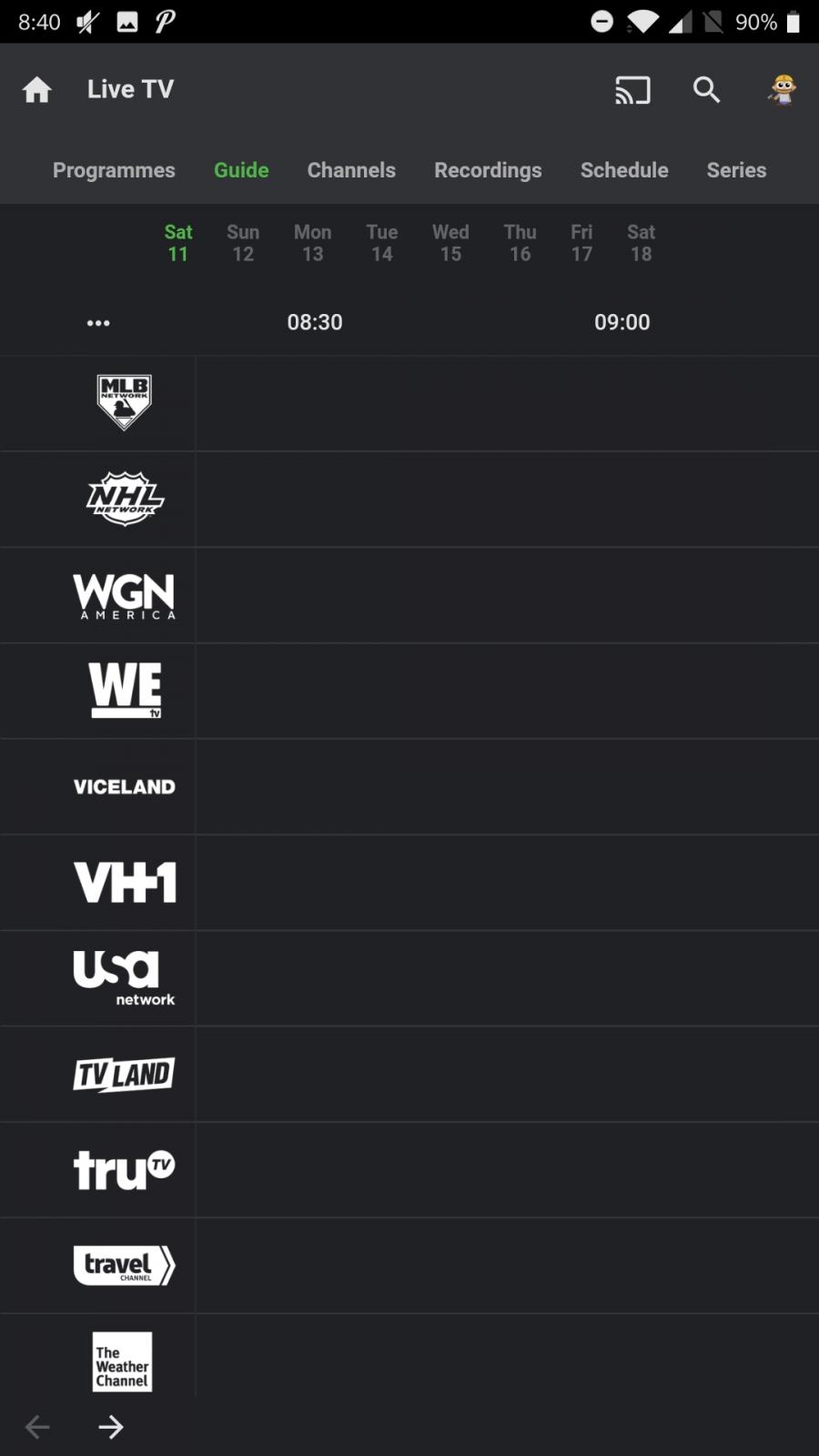

Pog22 52 Posted May 11, 2019 Author Posted May 11, 2019 As you can see the channels are mapped to the epg, they are just not showing in guide

Pog22 52 Posted May 11, 2019 Author Posted May 11, 2019 (edited) Just curious but after loading the M3U and XML EPG file, did you map the channels from the M3U to the EPG? They are from the provider and in the screenshot above you can see they are showing as mapped correctly. The same EPG works on another Emby server This is very strange, it's as if there'a an old blank EPG stuck in Emby if you know what i mean. Without an M3u or EPG added it goes through the motions of downloading an EPG data when I hit refresh that takes a min or 2. Where does Emby cache the EPG so I can manually delete it? Edit. is it cache/xmltv? is it safe to delete the contents and do a refresh or is that storing other info. there is a lot of xml files in there Edited May 11, 2019 by colfin22
