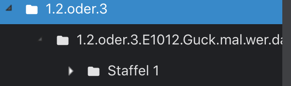

Che8o 1 Posted May 10, 2019 Posted May 10, 2019 Hello, since upgrading to Emby 4 (4.1.1.0), some series are not properly indexed anymore or at least not combined into a single series. Example from the directory: TV-Serien/1.2.oder.3# ls -1 1.2.oder.3.E1012.Guck.mal.wer.da.bellt.German.WS.720p.HDTV.x264-SQUiZZiEs 1.2.oder.3.E1040.Frisch.aus.der.Fabrik.German.WS.720p.HDTV.x264-SQUiZZiEs 1.2.oder.3.E1041.Von.Strudeln.Spiralen.und.Feuertornados.German.WS.720p.HDTV.x264-SQUiZZiEs 1.2.oder.3.E1042.Hier.brummt.der.Baer.German.WS.720p.HDTV.x264-SQUiZZiEs 1.2.oder.3.E1043.Superschiffe.German.WS.720p.HDTV.x264-SQUiZZiEs 1.2.oder.3.E1044.Basta.Pasta.German.WS.720p.HDTV.x264-SQUiZZiEs 1.2.oder.3.E1052.Wunderbauten.der.Welt.German.WS.720p.HDTV.x264-SQUiZZiEs 1.2.oder.3.E1053.Auf.und.ab.German.WS.720p.HDTV.x264-SQUiZZiEs 1.2.oder.3.E1054.Schweiz.German.WS.720p.HDTV.x264-SQUiZZiEs 1.2.oder.3.E1055.Guten.Morgen.German.WS.720p.HDTV.x264-SQUiZZiEs 1.2.oder.3.E1056.Elton.feat.Dein.Song.German.WS.720p.HDTV.x264-SQUiZZiEs 1.2.oder.3.E1057.Wunderbare.Waelder.German.WS.720p.HDTV.x264-SQUiZZiEs 1.2.oder.3.E1058.Rudern.und.Paddeln.German.WS.720p.HDTV.x264-SQUiZZiEs 1.2.oder.3.E1059.Kunterbunte.Natur.German.WS.720p.HDTV.x264-SQUiZZiEs 1.2.oder.3.E1060.Grandioses.Gemuese.German.WS.720p.HDTV.x264-SQUiZZiEs 1.2.oder.3.E1061.Raubkatzen.German.WS.720p.HDTV.x264-SQUiZZiEs 1.2.oder.3.E1062.Nicht.nur.Plastik.German.WS.720p.HDTV.x264-SQUiZZiEs 1.2.oder.3.E1063.Elton.und.Die.Sportmacher.German.WS.720p.HDTV.x264-SQUiZZiEs 1.2.oder.3.E1064.Niedliche.Nager.German.WS.720p.HDTV.x264-SQUiZZiEs 1.2.oder.3.E1065.Retter.in.der.Not.German.WS.720p.HDTV.x264-SQUiZZiEs 1.2.oder.3.E1066.Vom.Schaf.zum.Pulli.German.WS.720p.HDTV.x264-SQUiZZiEs In Emby this looks like in the screenshot attached (regular view + meta-manager). This used to be different and I'm not sure if this is jus ta violation of the naming scheme now or something has changed here since 4. Can you help me? Thanks!

Che8o 1 Posted May 10, 2019 Author Posted May 10, 2019 (edited) Hi ebr, yes those are episodes of a series that does not have seasons and is just consecutive. Same as for example https://www.thetvdb.com/series/scene-of-the-crime-1/seasons/2013. I get the naming scheme part and was also not sure about this, but did anything change here? This was not an issue in 3.x. Do you see any way to fix this without renaming all the files? Thanks! Edited May 10, 2019 by Che8o

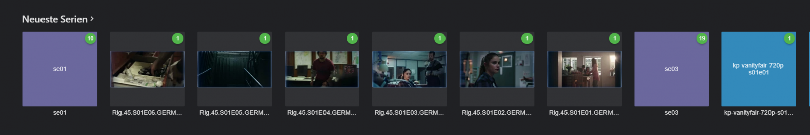

latinumking 7 Posted May 11, 2019 Posted May 11, 2019 (edited) Sorry for entering this thread, I have a pretty similar issue. I am following the naming convention, have also german language tv-shows and all but silly display in my emby home screen. I cannot tell since when this happend, from my guess, i have this issue for about 3 months now. I did delete the tv-shows library, rebuilt, but the silly display remains unfortunately. I read trough this forum, this is the only post that seems quite similar to my issue. I enclose a screenshot of the relevant home screen. If you have a look for example on the rig folder structure, everything looks rather ok (at least to me): I did select the multi directory flag in the series menu. I have no screenshot from the past but I have the impression that under series / TV shows, I just saw the series not the respektive episodes of the show. It gets even worse, if I have a look at the series: Every episode is displayed in a 1:1 relation... Thank you for your help. Cheers, Lati Edited May 11, 2019 by latinumking

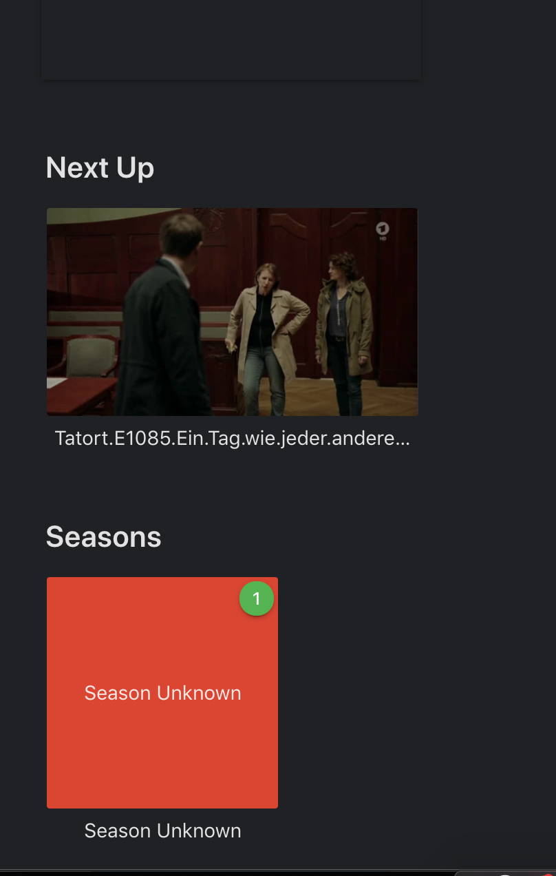

Luke 42219 Posted May 14, 2019 Posted May 14, 2019 The only difference I can see in the beta is now it says "Season unknown" on each of these individual files. Still, they are not organized under the Umbrella of the series. What do you mean by this? Can you show a new screenshot? Thanks !
Che8o 1 Posted May 14, 2019 Author Posted May 14, 2019 What do you mean by this? Can you show a new screenshot? Thanks ! Here you go. Is there any source I could diff between 4 and 3 to have a closer look or can you suggest any meta-manager changes to make this work? This is quite annoying and I can't be renaming files for the lifetime of this series (and others).
Luke 42219 Posted May 14, 2019 Posted May 14, 2019 There's no season in the filename, that's why this is happening. For best results you need to use a supported tv naming convention: https://github.com/MediaBrowser/Wiki/wiki/TV-naming Please let us know if this helps. Thanks.

pwhodges 2028 Posted May 14, 2019 Posted May 14, 2019 Try renaming your parent folder from "se01" to "Season 1" and rescan, it should be identified correctly then. I guess a way to understand why this might muck things up is that "se01" looks like the code for "Season null Episode 01" - which would match the message "Season Unknown".

latinumking 7 Posted May 14, 2019 Posted May 14, 2019 I guess a way to understand why this might muck things up is that "se01" looks like the code for "Season null Episode 01" - which would match the message "Season Unknown". Indeed, it worked in the past, all my tv shows are sorted like this (se01 se02..). It started about 2 or 3 months ago to get the strange effect. I did try to start to rename them to season 1... and it works. To me, this is like a downgrade, however, I will start remaning all my tv shows back on track. honestly speaking, to me, Thank you all for your help. Kind regards, Lati
