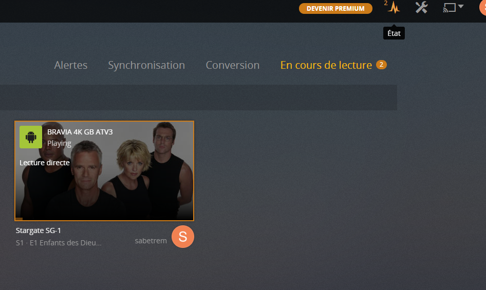

Sabetrem 0 Posted May 9, 2019 Posted May 9, 2019 Hello, I would need some information, I have a Synology DS414 NAS server and a Sony TV (2018) and another TV with a xiaomi box s. I installed Emby and Plex Server on android apps on the drives, and my heart has a big preference for Emby, however, but i have a problem with it. Many movies and series in my library can not be without transcoding, that's not a problem. It takes a great price for it not to be read directly. My 2018 Sony TV and x-boxes, are quite capable of decoding movies and car series can work in direct reading with PLEX. The problem comes beautifully and well from Emby. Do you have a solution? Thank you in advance for your assistance. Log.txt

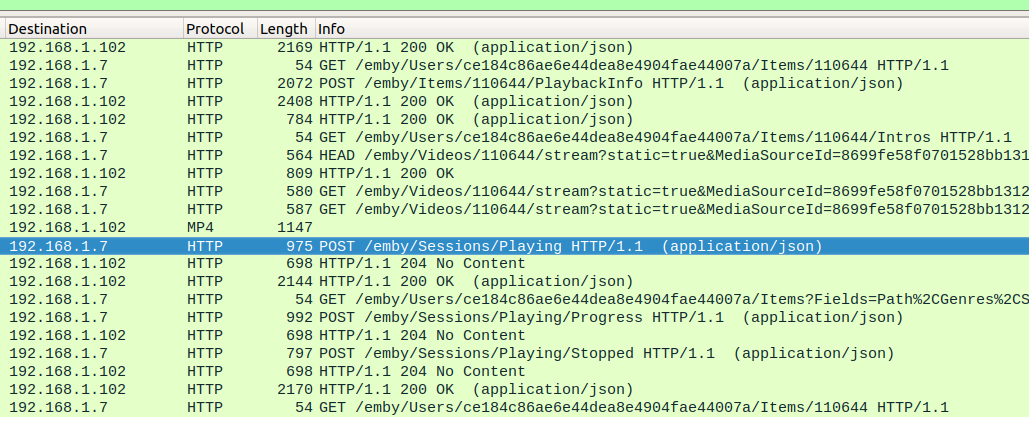

tshegofatso100 2 Posted May 28, 2019 Posted May 28, 2019 (edited) Hi Guys ive been trying to find out why is it that Android TV App is not allowing to play Media that needs to be transcoded. So I am connecting to the server that is behind the reverse proxy and i think i set this up properly. Because the Emby App is working properly and Kodi is also working properly. So this is what i did to try to capture the traffic between the my Emby Server and my Clients. I have a middle server that does reverse proxy. Client >reverse proxy > emby server For code when playing a direct string media and show only the HTTP request from using TCP dump. The highlisted string here it is when i check the http stream. The following are examples for Emby for android TV this is the HTTP request between my server and proxy server. The highlighted line i expanded it by using follow HTTP stream on wireshark when trying to play a session that require trascoding this is what i get when i look at Apache logs. The following is from Wireshark As you can see it delete the active transcoding and the player just changes because the playing status return an internal error 500. Can you please assist in solving this issue i have added the files ffmpeg-transcode-0e1f200d-3e99-44b3-8a21-a146f994b872_1.txt embyserver.txt Edited May 28, 2019 by tshegofatso100

Luke 42246 Posted May 28, 2019 Posted May 28, 2019 Have you tried the same scenario inside your network without going through the reverse proxy?
tshegofatso100 2 Posted May 28, 2019 Posted May 28, 2019 Its working inside the network. however i want move my from inside my house because it makes to much noise to a different place.
ebr 16338 Posted May 29, 2019 Posted May 29, 2019 Hi. It seems something with the reverse proxy must not be configured properly. We've seen this type of thing in the past where the proxy is not forwarding on the post data for a request we send and, therefore, the server doesn't get all the information it needs.
tshegofatso100 2 Posted May 29, 2019 Posted May 29, 2019 However the same post is working with the emby app and emby - kodi plugin, however the emby for android TV is not working.
ebr 16338 Posted May 30, 2019 Posted May 30, 2019 However the same post is working with the emby app and emby - kodi plugin, however the emby for android TV is not working. Some of the other apps provide information like the user ID on the url instead of in the post data. So, while it appears that they are working, they likely are not working properly.

pir8radio 1313 Posted June 4, 2019 Posted June 4, 2019 (edited) I think you are thinking of this thread ebr: https://emby.media/community/index.php?/topic/54890-firetv-wont-play-any-video/?hl=%2Bapache+%2Bproxy+%2Bpir8radio&do=findComment&comment=534267 @@tshegofatso100 read through that and check that its not a cert chain issue. Maybe you already did, i didn't go back in this thread and read everything.. I'm not a sales-man for nginx, but i would suggest changing to nginx. Its native for linux, if you use windows there is a good windows version out there that is pretty amazing.. lol I know it "works on other devices" but how they do some of the emby clients can be a bit strange, using different "native" players in some OS's and devices, the requests for video comes from those players so it can inject some confusion to the troubleshooting process. Edited June 4, 2019 by pir8radio
Solution ebr 16338 Posted June 4, 2019 Solution Posted June 4, 2019 No, it isn't a certificate issue. His proxy is not passing along the post data for the requests. I'm afraid the only solution we've seen so far is using nginx instead...
