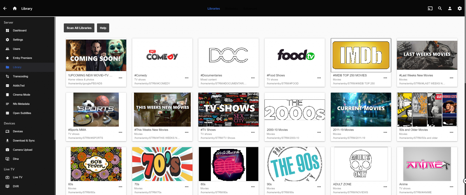

Westiewill 16 Posted May 6, 2019 Author Posted May 6, 2019 @@Westiewill what do you mean? What theme hides what? I copied and pasted a dark theme css from the css section on this community forum.. it blacks out the other options but once u select it blindly it switches over to blue font on black bg here is a screenshot explaining this
Luke 42246 Posted May 6, 2019 Posted May 6, 2019 Ok yes I would suggest removing the custom css. Thanks.
