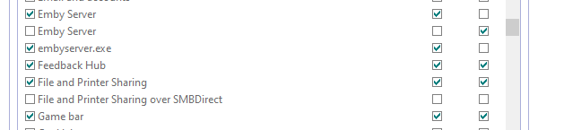

Embyjunky 2 Posted May 4, 2019 Posted May 4, 2019 All, I need some helps trying to fix a issue with the server keep disconnecting. Fresh Windows 10 Ver. 1903 Latest Emby Server version Client = Nvidia Shield/Kodi Symptom: Emby started fine but after a few minutes, it will disconnect. Emby Tray Icon is still showing but if I tried to launch it from there, I get localhost:8096 not found I can EXIT Emby Tray Icon and launch it again but the same cycle continues. I tried to review the logs but I am no expert by any means. I have a feeling it might have something with the firewall/port setting but I can't say for sure. Thanks for your supports. Log1.txt Log2.txt Log3.txt
