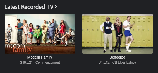

saturnaqua 5 Posted May 2, 2019 Posted May 2, 2019 I switched from using serverwmc/wmc with emby to pure emby for recording OTA shows. Seems to be working great, but I noticed that sometimes the shows it records are showing up wierd when I see the latest recordings. For instance, tonight, it recorded the sitcom "Schooled". Normally it would show a series banner, but tonight it did not. When I checked, it turns out before it was putting the recordings into a folder "Schooled (2019)\Season 1", but tonight it decided to put it into "Schooled\Season 1". I saw a similar issue last night with "The Flash" where it put it into a folder as if it was the 90's version of the show, not the one starting in 2014. I ended up moving the shows to the correct folders with the correct years and then the display shows properly and I checked the logs but I'm not sure why it decides to place the recordings in the wrong spot initially. I attached the log, but I guess the interesting part is: 2019-05-01 20:27:00.008 Info App: Recording timer fired for Schooled. 2019-05-01 20:27:00.010 Info HttpClient: GET https://www.thetvdb.com/api/GetSeriesByRemoteID.php?zap2it=EP02970576&language=en 2019-05-01 20:27:00.813 Info HttpClient: GET https://www.thetvdb.com/api/GetSeries.php?seriesname=Schooled&language=en 2019-05-01 20:27:01.430 Info HttpClient: GET https://www.thetvdb.com/api/B89CE93890E9419B/series/352016/all/en.zip 2019-05-01 20:27:01.974 Info App: MovieDbProvider: Finding id for item: Schooled 2019-05-01 20:27:01.974 Info HttpClient: GET https://api.themoviedb.org/3/search/tv?api_key=f6bd687ffa63cd282b6ff2c6877f2669&query=Schooled&language=en 2019-05-01 20:27:02.333 Info HttpClient: GET https://private.omdbapi.com?apikey=fe53f97e&plot=full&r=json&s=Schooled&type=series 2019-05-01 20:27:02.597 Info App: Getting media sources for recording from channel 135823 135823 2019-05-01 20:27:02.598 Info App: Opening live stream for recording from channel 135823 135823 2019-05-01 20:27:02.599 Info App: Opening channel stream from Emby, external channel Id: hauppauge_9 2019-05-01 20:27:02.599 Info App: Streaming Channel hauppauge_9 2019-05-01 20:27:02.599 Info App: Live stream native_998ad3d028988bf113943887d48ba6c0_a7690f6963dcb6b3464cd97ea5565b10 consumer count is now 2 2019-05-01 20:27:02.638 Info MediaSourceManager: Live tv media info probe took 0.039013 seconds 2019-05-01 20:27:02.638 Info MediaSourceManager: Live stream opened: {"Protocol":"Http","Id":"native_998ad3d028988bf113943887d48ba6c0_a7690f6963dcb6b3464cd97ea5565b10","Path":"http://127.0.0.1:8096/LiveTv/LiveStreamFiles/f888247956704645a954556e97ad8e7b/stream.ts","Type":"Default","Container":"mpegts","IsRemote":false,"SupportsTranscoding":true,"SupportsDirectStream":true,"SupportsDirectPlay":false,"IsInfiniteStream":true,"RequiresOpening":true,"RequiresClosing":true,"LiveStreamId":"06044cf0e6f93cdae5f285c9ecfaaeb4_01413a525b3a9622ce6fdf19f7dde354_native_998ad3d028988bf113943887d48ba6c0_a7690f6963dcb6b3464cd97ea5565b10","RequiresLooping":false,"SupportsProbing":false,"MediaStreams":[{"Codec":"mpeg2video","TimeBase":"1/90000","CodecTimeBase":"1001/60000","VideoRange":"SDR","DisplayTitle":"720p MPEG2VIDEO","IsInterlaced":false,"BitRate":8000000,"RefFrames":1,"IsDefault":false,"IsForced":false,"Height":720,"Width":1280,"AverageFrameRate":59.94006,"RealFrameRate":59.94006,"Profile":"Main","Type":"Video","AspectRatio":"16:9","Index":-1,"IsExternal":false,"IsTextSubtitleStream":false,"SupportsExternalStream":false,"PixelFormat":"yuv420p","Level":4,"IsAnamorphic":false},{"Codec":"ac3","CodecTag":"AC-3","TimeBase":"1/90000","CodecTimeBase":"1/48000","DisplayTitle":"Dolby Digital 5.1","IsInterlaced":false,"ChannelLayout":"5.1","BitRate":384000,"Channels":6,"SampleRate":48000,"IsDefault":false,"IsForced":false,"Type":"Audio","Index":-1,"IsExternal":false,"IsTextSubtitleStream":false,"SupportsExternalStream":false,"Level":0}],"Formats":[],"Bitrate":8384000,"RequiredHttpHeaders":{},"ReadAtNativeFramerate":false} 2019-05-01 20:27:02.639 Info App: Will record to D:\Recorded TV\Schooled\Season 1\Schooled S01E12 CB Likes Lainey.ts for 35.956010645 minutes. And here's a snippet from The Flash where it decided it was the 1990's version: 2019-04-30 19:57:00.000 Info App: Recording timer fired for The Flash. 2019-04-30 19:57:00.070 Info HttpClient: GET https://www.thetvdb.com/api/GetSeriesByRemoteID.php?zap2it=EP01922936&language=en 2019-04-30 19:57:00.438 Info HttpClient: GET https://www.thetvdb.com/api/GetSeries.php?seriesname=The+Flash&language=en 2019-04-30 19:57:00.525 Info HttpClient: GET https://www.thetvdb.com/api/B89CE93890E9419B/series/78650/all/en.zip 2019-04-30 19:57:01.011 Info App: MovieDbProvider: Finding id for item: The Flash 2019-04-30 19:57:01.011 Info HttpClient: GET https://api.themoviedb.org/3/search/tv?api_key=f6bd687ffa63cd282b6ff2c6877f2669&query=The+Flash&language=en 2019-04-30 19:57:01.428 Info HttpClient: GET https://private.omdbapi.com?apikey=fe53f97e&plot=full&r=json&s=The+Flash&type=series 2019-04-30 19:57:01.890 Info App: Getting media sources for recording from channel 135832 135832 2019-04-30 19:57:01.976 Info App: Opening live stream for recording from channel 135832 135832 2019-04-30 19:57:01.986 Info App: Opening channel stream from Emby, external channel Id: hauppauge_1 2019-04-30 19:57:01.989 Info App: Streaming Channel hauppauge_1 2019-04-30 19:57:01.995 Info App: GetChannelStream: channel id: hauppauge_1. stream id: native_5fd6aeea2c161c9d1298e151521ac18c_a7690f6963dcb6b3464cd97ea5565b10 2019-04-30 19:57:01.996 Info App: Hauppauge GetChannelStream args "GetChannelStream" "1" "1" "native_5fd6aeea2c161c9d1298e151521ac18c_a7690f6963dcb6b3464cd97ea5565b10" 2019-04-30 19:57:03.769 Info App: Live stream opened after 2.5105ms 2019-04-30 19:57:03.770 Info App: Returning mediasource streamId native_5fd6aeea2c161c9d1298e151521ac18c_a7690f6963dcb6b3464cd97ea5565b10, mediaSource.Id native_5fd6aeea2c161c9d1298e151521ac18c_a7690f6963dcb6b3464cd97ea5565b10, mediaSource.LiveStreamId null 2019-04-30 19:57:03.872 Info MediaSourceManager: Live tv media info probe took 0.0604939 seconds 2019-04-30 19:57:03.873 Info MediaSourceManager: Live stream opened: {"Protocol":"Http","Id":"native_5fd6aeea2c161c9d1298e151521ac18c_a7690f6963dcb6b3464cd97ea5565b10","Path":"http://127.0.0.1:8096/LiveTv/LiveStreamFiles/49575c103d5247ccb5b8bb9f8cf3b509/stream.ts","Type":"Default","Container":"mpegts","IsRemote":false,"SupportsTranscoding":true,"SupportsDirectStream":true,"SupportsDirectPlay":false,"IsInfiniteStream":true,"RequiresOpening":true,"RequiresClosing":true,"LiveStreamId":"06044cf0e6f93cdae5f285c9ecfaaeb4_01413a525b3a9622ce6fdf19f7dde354_native_5fd6aeea2c161c9d1298e151521ac18c_a7690f6963dcb6b3464cd97ea5565b10","RequiresLooping":false,"SupportsProbing":false,"MediaStreams":[{"Codec":"mpeg2video","TimeBase":"1/90000","CodecTimeBase":"1001/60000","VideoRange":"SDR","DisplayTitle":"720p MPEG2VIDEO","IsInterlaced":false,"BitRate":8000000,"RefFrames":1,"IsDefault":false,"IsForced":false,"Height":720,"Width":1280,"AverageFrameRate":59.94006,"RealFrameRate":59.94006,"Profile":"Main","Type":"Video","AspectRatio":"16:9","Index":-1,"IsExternal":false,"IsTextSubtitleStream":false,"SupportsExternalStream":false,"PixelFormat":"yuv420p","Level":4,"IsAnamorphic":false},{"Codec":"ac3","CodecTag":"AC-3","TimeBase":"1/90000","CodecTimeBase":"1/48000","DisplayTitle":"Dolby Digital 5.1","IsInterlaced":false,"ChannelLayout":"5.1","BitRate":384000,"Channels":6,"SampleRate":48000,"IsDefault":false,"IsForced":false,"Type":"Audio","Index":-1,"IsExternal":false,"IsTextSubtitleStream":false,"SupportsExternalStream":false,"Level":0}],"Formats":[],"Bitrate":8384000,"RequiredHttpHeaders":{},"ReadAtNativeFramerate":false} 2019-04-30 19:57:03.878 Info App: Will record to D:\Recorded TV\The Flash (1990)\Season 5\The Flash S05E20 Gone Rogue.ts for 65.9353640233333 minutes. I also attached a snip of the directory structure that got created. Do I need to change some setting on the recorded tv library it automatically added or is there some other option I need to tweak somewhere for this? Or is there some source data not providing the right data upstream causing this issue? Log.txt
