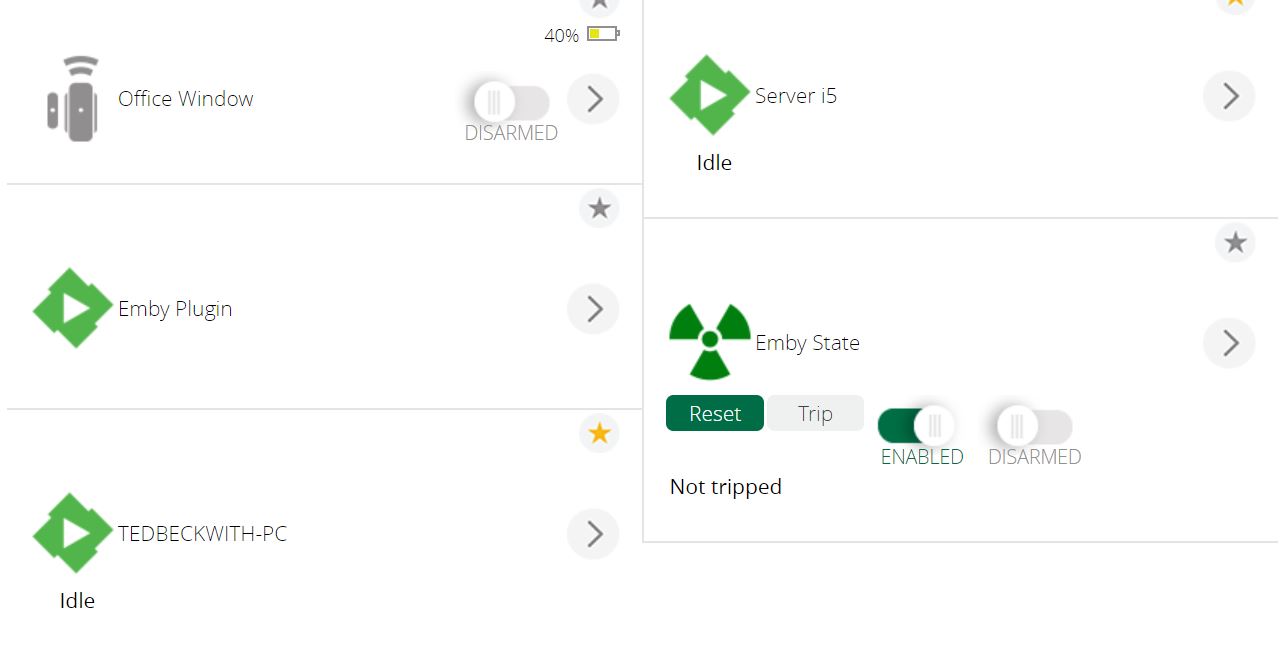

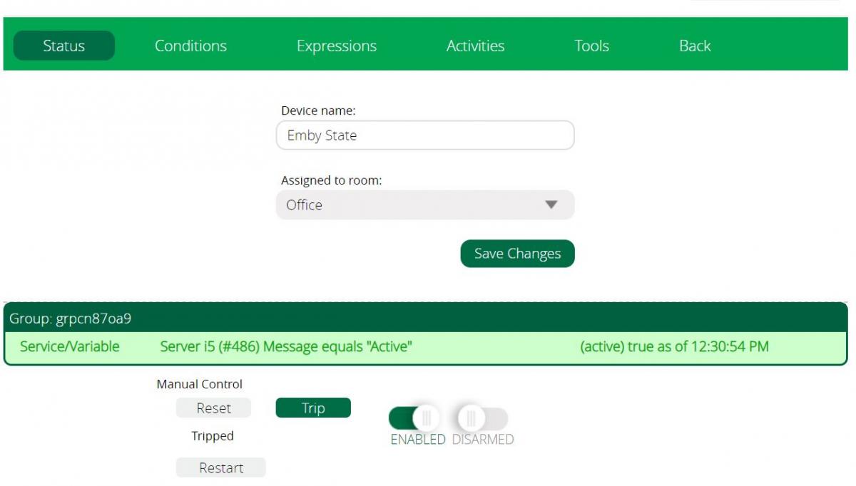

Sammy 791 Posted May 2, 2019 Author Posted May 2, 2019 (edited) I got Reactor to trip when the Emby Server was "Active". I'm pretty sure I can get Reactor to trip when the server is idle.. Now to figure out how to get that into a script to tell Windows when to run and not to run MCEBuddy. Edited May 2, 2019 by Sammy

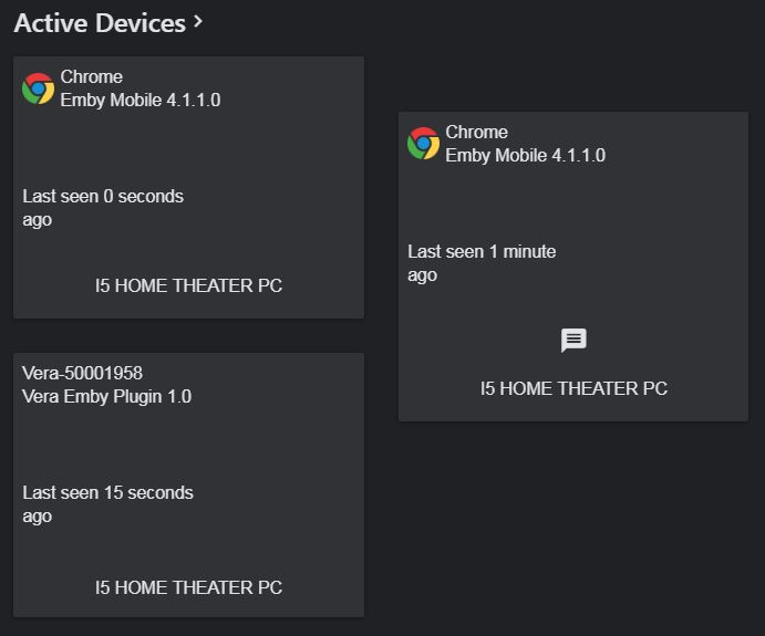

Sammy 791 Posted May 13, 2019 Author Posted May 13, 2019 This is what I see in Emby and in Vera. I'm not sure if it gives you the information you need? .
Sammy 791 Posted May 13, 2019 Author Posted May 13, 2019 BTW, whenever I look at the Emby Plugin in Vera, the "Last Seen" value in Emby resets. Also, refreshing the Emby Dashboard over the course of 60 Seconds and the "Last Seen" value resets to 0. Short answer is that I believe that the Emby Plugin in Vera is "active" in Emby every 60 seconds when it checks the idle state. It seems it would need to be white listed. BTW, thank you @@chef ! I think that there could be other useful purposes for a plugin such as this. What say you @@Luke and @@ebr ?
