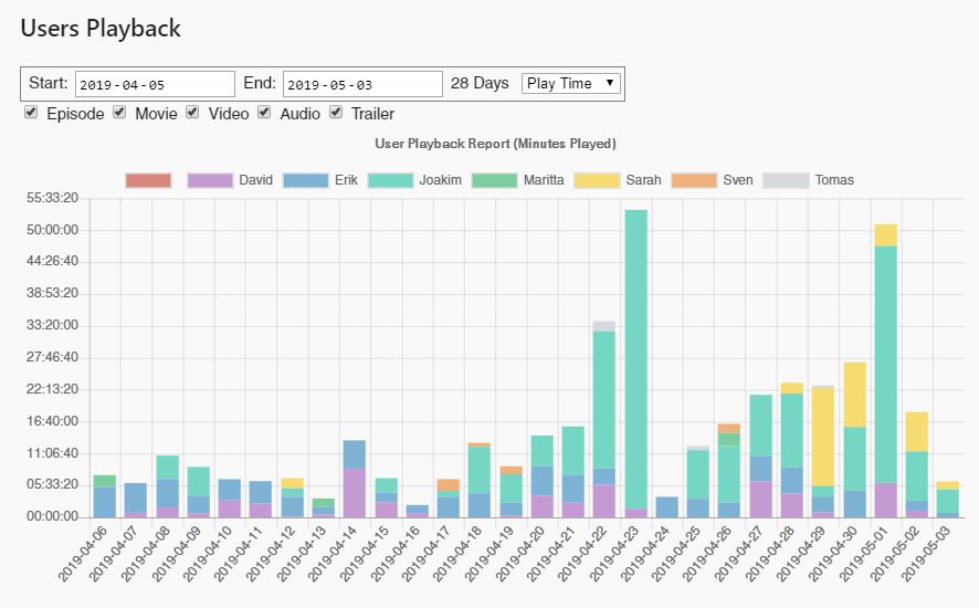

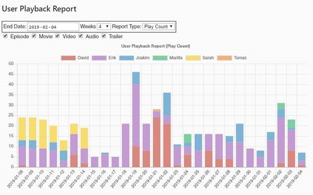

redaktorn 24 Posted May 1, 2019 Posted May 1, 2019 (edited) Hi, I just updated to server version 4.1.1.0 Running EMBY Server on a Linux Mint 18.3 system. After updated I noticed that the graphical chart disappered in plugin "Playback Reporting" under "Playback". Marked in yellow in attachment. I also attach the chart as it use to look before it disappear. There used to be a nice chart showing playtime with all users that has been active last 4 weeks. I am rather sure this problem is not because of my system. I check this plugin every evening to see what is going on and it has always worked just fine. The chart disappered just after I updated to latest EMBY Server this evening. (Which I did just 20 minutes ago) Hope it gets working again, because I really appreciate that plugin. P.S: The problem is also visable under "Breakdown" where "Breakdown user" does not show anything. Seems that the plugin can not reach the user information in system? Edited May 1, 2019 by redaktorn

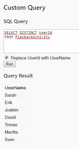

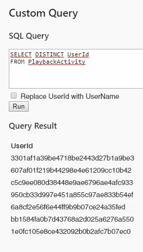

redaktorn 24 Posted May 3, 2019 Author Posted May 3, 2019 (edited) I think it is something weird in your collected data. On the plugin page there is a Query Tab at the top, go to that tab and enter the following query and hit run SELECT DISTINCT UserId FROM PlaybackActivity Then click the "Replace UserId with UserName" check box and run it again. Post or PM to me both your results. I runned the queries you asked for. It seems to be normal reply on those. (Files attached) Edited May 3, 2019 by redaktorn
redaktorn 24 Posted May 3, 2019 Author Posted May 3, 2019 Hmm that is super weird, I will keep looking Seems I have a strange problem. Thanks for looking into it. I will try to uninstall/install in the coming weekend. Maybe that can help.

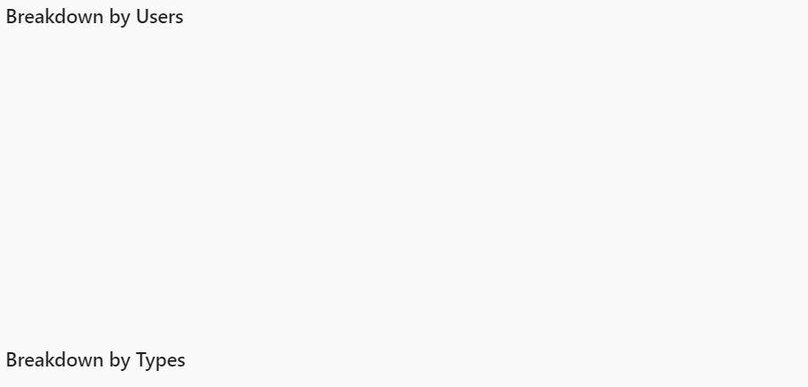

redaktorn 24 Posted May 3, 2019 Author Posted May 3, 2019 Hi TeamB, You are really quick to respond - Thank you. It seems that you solved the chart under "Playback reporting" - "Playback". But it is still missing under "Playback reporting" - "Breakdown". See pictures attached. 1

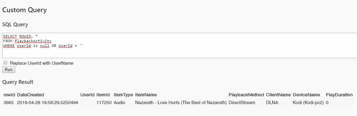

redaktorn 24 Posted May 3, 2019 Author Posted May 3, 2019 Ok based on your image from above it looks like I was correct the first time, I have no idea why my query did not show your user issue last time. It looks like your user list has an extra entry that is null or empty, you can see this in the above image with the color block with no name next to it. Can you try running this query in the Query tab SELECT ROWID, * FROM PlaybackActivity WHERE UserId is null OR UserId = '' post your results Hi TeamB, Thanks for all your help Yes I have an empty user because I deleted one user yesterday that was not active in a year. But deleting a user should not cause an error - or? I can reset the database and start over if you tell me how to do. I don't think that the deleted user caused the problem under "Breakdown". That problem was there before i deleted that user. Maybe you need to do the same kind of coding in that page as you did in "Playback"? Attached the result of the query.
redaktorn 24 Posted May 3, 2019 Author Posted May 3, 2019 Anybody else who can confirm (or not) that they have the same problem under "Breakdown" (No chart under user breakdown - just empty) See attachment
redaktorn 24 Posted May 3, 2019 Author Posted May 3, 2019 boom there it is, entry 3965 is all sorts of %^&* up Run this in the query TAB DELETE FROM PlaybackActivity WHERE ROWID = 3965 Ok - query done. See attchment I think that line was added because that song was played by DLNA. (I normally don't use DLNA but I probably have been testing some time)

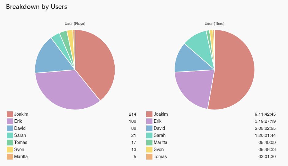

redaktorn 24 Posted May 3, 2019 Author Posted May 3, 2019 Problem solved Seems it was that line that caused the problem under "Breakdown by User". Now it works again TeamB - Thank you very much for your kind help. Last question in this subject: Does this mean that I should avoid playing anything by DLNA?
redaktorn 24 Posted May 3, 2019 Author Posted May 3, 2019 That query should have deleted one entry and you should now be able to view all the charts Yes I can see all charts now - Thank you. Was it because that line was added when playing by DLNA? (Or was it just a coincidence maybe?)
