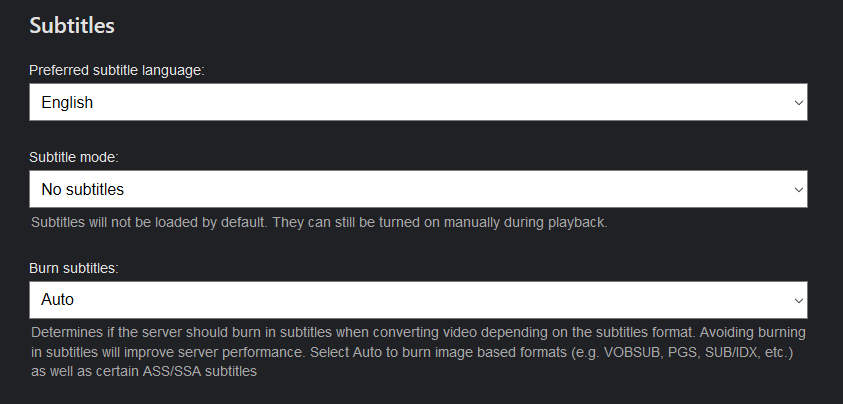

bigverm23 2 Posted April 30, 2019 Author Posted April 30, 2019 (edited) So I have subtitle mode set to no subtitles and allow subtitle extraction on the fly....where else would I turn it off? Edited April 30, 2019 by bigverm23
Luke 42246 Posted April 30, 2019 Posted April 30, 2019 My mistake, this one isn't burning in subtitles, but there will still be some CPU involved. @sodtworkz may have more insight.
