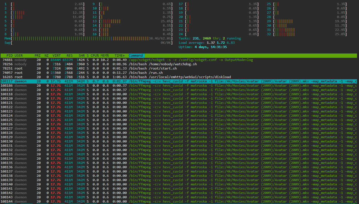

iamspartacus 40 Posted April 29, 2019 Posted April 29, 2019 (edited) Is this normal? If I start a stream session which forces a transcode (HW) and then close the session (no active streams showing up in dashboard) I'm still seeing the transcode session processing in my GPU well after (it's been 10+ minutes so far) the stream was closed. Furthermore, I tried restarting the server and the transcode session picks right back up. Again, no active streams. What's the best way for me to produce clean logs for troubleshooting this? Edited April 29, 2019 by iamspartacus

iamspartacus 40 Posted April 29, 2019 Author Posted April 29, 2019 (edited) What's your approach for 'still seeing the transcode session processing in my GPU' ? Are you able to retrieve a list of running processes? In this list, could you look for processes named 'ffmpeg' in situations where you think that transcode sessions would be progressing? Do you see the attached screen shot? It answers your questions. That is a live look at my GPU processes that is in real time. Edited April 29, 2019 by iamspartacus
softworkz 5130 Posted April 29, 2019 Posted April 29, 2019 No, it doesn't. Please answer mine. PS: Please use a native OS-provided method to retrieve a process list.
iamspartacus 40 Posted April 29, 2019 Author Posted April 29, 2019 No, it doesn't. Please answer mine. PS: Please use a native OS-provided method to retrieve a process list.
softworkz 5130 Posted April 29, 2019 Posted April 29, 2019 Thanks for the list. That's looking really bad... What OS is this? How did you install Emby? Why is ffmpeg being run from '/bin/ffmpeg' ? We're shipping a custom ffmpeg version and iirc, this is located in a different folder. Would you be able to post a hardware detection log and just one of the ffmpeg logs? Thank you very much.

softworkz 5130 Posted April 29, 2019 Posted April 29, 2019 I'm not sure if those zombie processes are really 'using' the GPU. It rather seems that those ffmpeg processes have crashed for some reason but without actually exiting the process. I come to this conclusion because all those remaining processes that we could see in the list that you posted are using the exact same amount of memory. That's no coincidence. Instead, there must be a certain operation leading to a crash always in the exact same way. Otherwise they would show variable memory allocations. In your screenshot, all visible instances were about playback of just a single movie. It would be good if you could observe this situation for a while to see whether those problems could be isolated to a single video or a certain group of movies (e.g. HEVC or HEVC, 10bit). But probably you should do a restart first, to get right of all that junk that has been aggregating so far..
