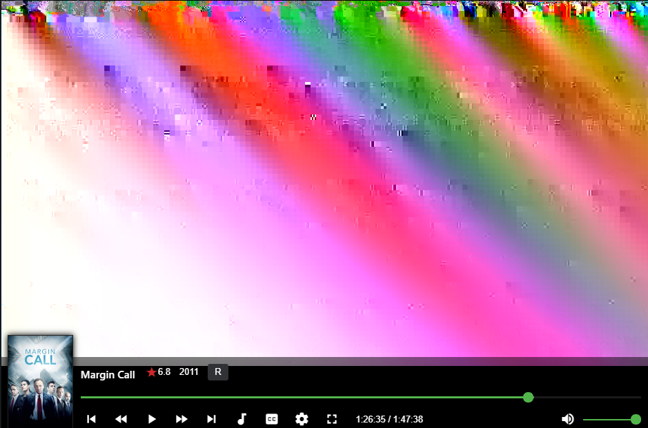

Chris Able 0 Posted April 30, 2019 Author Posted April 30, 2019 Hi, just add the issue with my in house pc. When I was watching a movie, the picture became like the attachment. then freeze. I'm continuing my investigation. Thanks
Happy2Play 9806 Posted April 30, 2019 Posted April 30, 2019 You would need to post the server and ffmpeg logs.
Chris Able 0 Posted May 1, 2019 Author Posted May 1, 2019 Hi here is the ffmpeg log. Let me know if it tells you something, thank you Log ffmpeg Emby.txt
Happy2Play 9806 Posted May 1, 2019 Posted May 1, 2019 Hi here is the ffmpeg log. Let me know if it tells you something, thank you If you lower the in-app quality does the same thing happen as it is transcoding your 7+Mb file to 14+Mb to try and maintain the quality converting hevc to h264? Does this happen if you disabled HWA?

Luke 42218 Posted May 1, 2019 Posted May 1, 2019 As a test, can you try turning off hardware acceleration under server transcoding settings? Try setting it to no. Please let me know how that compares. thanks !
Chris Able 0 Posted May 1, 2019 Author Posted May 1, 2019 Hello! Awesome! It seems to work! :-) I will continue testing it but is seems good. So, I will maintain this parameter off for now one Thank you for your time and for your help. It is really apreciate Chris
softworkz 5130 Posted May 2, 2019 Posted May 2, 2019 From the ffmpeg log, I can see that the output bit-rate is way too low. I'm not yet sure why this happens.. @@Chris Able - Do you have the latest AMD drivers installed? (from AMD - not the MS provided ones)
