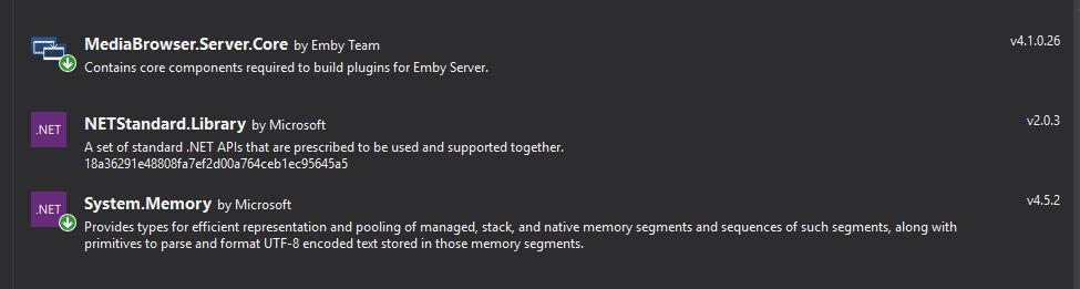

BillOatman 597 Posted April 29, 2019 Author Posted April 29, 2019 (edited) The only V4 one that's available, yes. I did notice though that this project references (via nuget) system.memory. And the one available via nuget looks like a lower version than the one that is installed with Emby. I tried building with the Emby one but it would not. But if dll hell was the problem, wouldn't I see that in the log when Emby tried to load this dll? I attached the solution in case that is quicker and easier than playing 20 questions emby.plugin.HueControl-1.1.0.zip Edited April 29, 2019 by BillOatman
