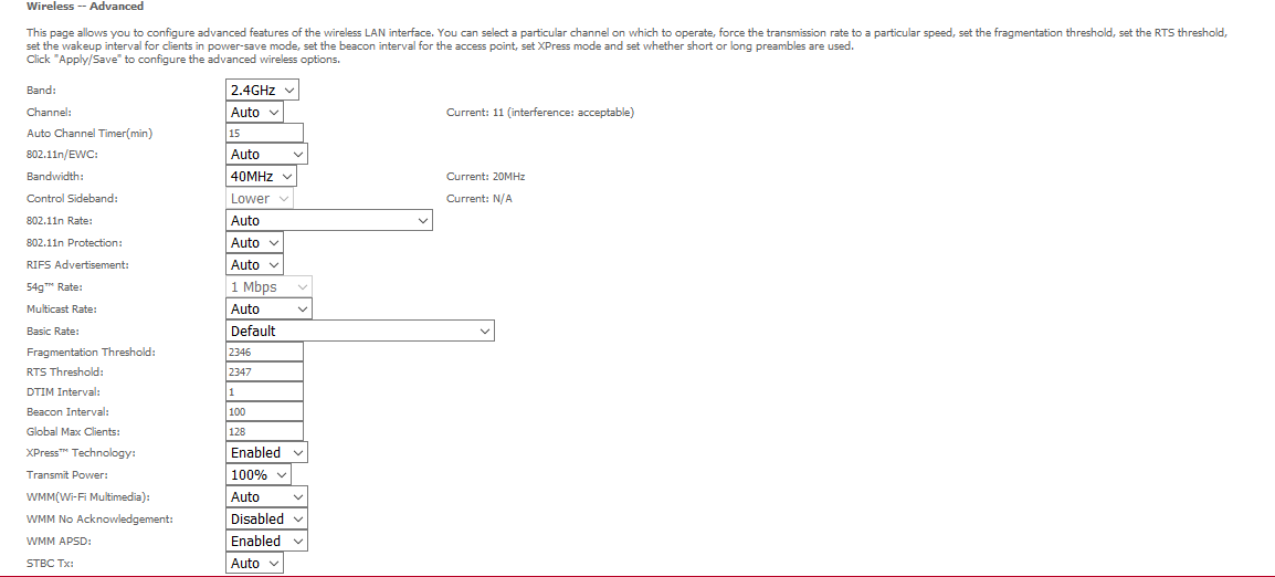

arche 177 Posted May 1, 2019 Posted May 1, 2019 Not a fan of this modem/router. But I know it's out of your control at the moment. Anyways, what do you have your WMM settings at?
ferds 0 Posted May 1, 2019 Author Posted May 1, 2019 This is everythig I found on WMM on the settings... The other thing I found is that when I connect to the server using the lan cable it works fine.
denz 501 Posted May 1, 2019 Posted May 1, 2019 (edited) can you disable wmm apsd and try wmm multimedia enable Edited May 1, 2019 by denz
ferds 0 Posted May 1, 2019 Author Posted May 1, 2019 I disabled WMM APSD but it didn't do anything WMM Multimedia can only be toggled between Auto and Disable.
denz 501 Posted May 1, 2019 Posted May 1, 2019 Darn the picture that you posted lookes very similar to my modems settings. I am out of suggestions.
