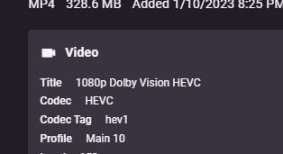

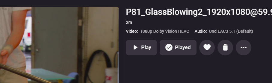

MSI2017 48 Posted March 7, 2023 Posted March 7, 2023 1 minute ago, Luke said: Oeh that's awesome, can't wait! Any ETA on release? Thanks Luke 1
neik 874 Posted March 7, 2023 Posted March 7, 2023 (edited) Will DV profiles be available as well or will it be a generic DV tag? Edited March 7, 2023 by neik 1
Cheesegeezer 3106 Posted March 7, 2023 Posted March 7, 2023 3 hours ago, Luke said: Just some advice. I would shorten that the to DV level… Dolby Vision as text looks great but is it 5.7 or 8, its quite important to identify those and then you can also handle them. its all feedback from the MediaInfo plugin thread and testing so great to see you fellas on it
Cheesegeezer 3106 Posted March 7, 2023 Posted March 7, 2023 3 hours ago, MSI2017 said: Oeh that's awesome, can't wait! Any ETA on release? Thanks Luke This will be more than likely in 4.8 release
softworkz 5133 Posted March 7, 2023 Posted March 7, 2023 2 minutes ago, Cheesegeezer said: Dolby Vision as text looks great but is it 5.7 or 8, its quite important to identify those and then you can also handle them I agree. The text "Dolby Vision" alone is not useful at all. Of course it also can't be expected that many will know about the meaning of the profile numbers. Whether it's HDR10 compatible or proprietary would be the most important information, I think. 1
Cheesegeezer 3106 Posted March 7, 2023 Posted March 7, 2023 2 minutes ago, softworkz said: I agree. The text "Dolby Vision" alone is not useful at all. Of course it also can't be expected that many will know about the meaning of the profile numbers. Whether it's HDR10 compatible or proprietary would be the most important information, I think. People that are investing into a DV TV will know what they are buying and will understand what they get from each level so.. I’m gonna throw your assumption out the door. those that just buy a 309-600 dollar, pound, euro tv are there to provide a tv to watch dancing on ice or some shit like that… them that know… know… and them that know want to know.
softworkz 5133 Posted March 7, 2023 Posted March 7, 2023 3 minutes ago, Cheesegeezer said: People that are investing into a DV TV will know what they are buying and will understand what they get from each level I don't buy that. Even myself already forgot which is which even though I implemented the detection. 12 minutes ago, softworkz said: Whether it's HDR10 compatible or proprietary would be the most important information I'm saying that because that's the information on which it depends whether Emby can show it with tone mapping on non-DV capable devices. 2 1
MSI2017 48 Posted March 7, 2023 Posted March 7, 2023 6 minutes ago, softworkz said: I don't buy that. Even myself already forgot which is which even though I implemented the detection. I'm saying that because that's the information on which it depends whether Emby can show it with tone mapping on non-DV capable devices. Related to this, will DV profile 5 tonemapping be implemented together with this? Seems like a logical pair
