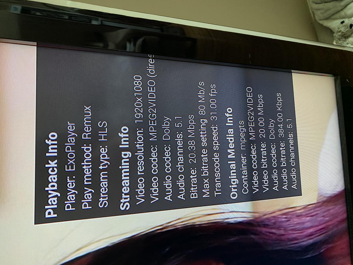

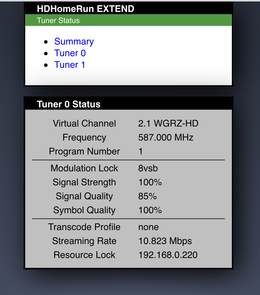

spuleckip 1 Posted April 17, 2019 Posted April 17, 2019 Hi, I’ve noticed this for the past month or so when watching live tv from my HDHomerun. Emby is recognizing the original media bitrate as 20.4 Mbps when this is never the case. 20.4 is probably the full stream including sub-channels, but never for one individual channel. Today, it showed that on my iPad and when I dialed into the HDHomerun it shows me the stream was 10.5 Mbps I’ve noticed, especially when traveling that a 20 Mbps stream is being used (or at least reported that way in stats for nerds) to transmit to devices both local and remote. I’ve never captured logs before but can read up on how to do this if necessary.
Luke 42245 Posted April 17, 2019 Posted April 17, 2019 Hi, the bitrate might have fluctuated from when the program started, that would explain the discrepancy between what the stats say vs hd homerun. I’ve noticed, especially when traveling that a 20 Mbps stream is being used (or at least reported that way in stats for nerds) to transmit to devices both local and remote. This isn't true. As you can see in the stats screenshot above, it is transcoding at 1.5 mbps, so it doesn't matter whether the source is 20 mbps or 10, it's still getting converted down to 1.5.
spuleckip 1 Posted April 17, 2019 Author Posted April 17, 2019 The screenshots weren’t meant to show the 20 Mbps stream, just the discrepancy in the bitrate. When I’m not on a cellular connection, it happens almost every time. I’ll attach two to this post showing this. All the stations in this area broadcast multiple sub-channels, so none of them have 20 Mbps to dedicate to the primary channel. In my earlier example, that channel packs two HD feeds (CBS and CW) as well as 2 SD feeds all in a single channel space. A single program wouldn’t be 20Mbps. The example I’m providing here, the station has an HD main program of NBC and 3 standard definition subs.

Luke 42245 Posted April 18, 2019 Posted April 18, 2019 Ok this isn't actually causing any problem. Those values are the values requested by the app. They are max values. You're not actually getting 640*480 @ 30 mbps. We will need to improve the stats display there. Do the server dashboard stats show the same value?
