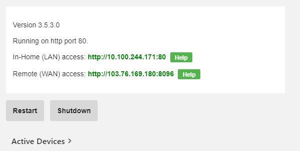

matrix0807 2 Posted April 16, 2019 Posted April 16, 2019 Hallo, i'm using emby for my friends on the same building. I used the portable version, like on picture i attach. the question is: the version i use is 3.5.3.0. and now on the download page https://emby.media/windows-server.html, the portable version is 4.0.3.0 how to update to new version? in version 3.5.3.0 i can't take metadata anymore from anywhere (imdb/tvdb,etc). is it just download the new version and overwrite the old files with new files on the same folder? thx
Happy2Play 9814 Posted April 16, 2019 Posted April 16, 2019 (edited) Technically auto update should work, but yes it is just a matter of getting the new system folder and replacing the existing system folder. Does the Dashboard not show this? Edited April 16, 2019 by Happy2Play
matrix0807 2 Posted April 16, 2019 Author Posted April 16, 2019 Technically auto update should work, but yes it is just a matter of getting the new system folder and replacing the existing system folder. Does the Dashboard not show this? No, my dashboard look like this: any idea how to update?
Solution Happy2Play 9814 Posted April 16, 2019 Solution Posted April 16, 2019 That version still had the app update scheduled task so I would run it. The server log should show any issues getting the update. But you can get it manually via the download page and you can manually replace the system folder if needed. Note as discussed on the forum 4.0 was a major upgrade. 1

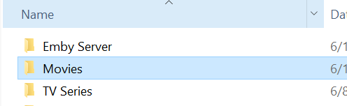

IkeTaylor11 61 Posted June 11, 2019 Posted June 11, 2019 Of course it does... Now, that path has to be valid, but you can type it in (as is indicated right there in the yellow call-out). Ok I figured that part out. But, it doesn't appear that the path without the drive letter works. I have attached a screen shot of my drive layout. What would I use for the path to add the Movies library? I tried \Movies and that didn't find any of the media.
ebr 16347 Posted June 11, 2019 Posted June 11, 2019 That screen shot doesn't show me enough context to answer that question but can you post the server log from the completed library scan after you added the folder?
IkeTaylor11 61 Posted June 11, 2019 Posted June 11, 2019 That screen shot doesn't show me enough context to answer that question but can you post the server log from the completed library scan after you added the folder? server log is attached. All folders are at the root of the drive. So my drive is E:\ right now. Emby Server - this is where emby portable is Movies - this is all my movies TV Shows - this is all my tv episodes I have tried \Movies and \Movies\ and neither option finds media after a library scan. embyserver.txt
ebr 16347 Posted June 11, 2019 Posted June 11, 2019 Why do you think it isn't finding the content? Here is someone actually playing an item from your movies path... 2019-06-11 08:36:43.039 Info HttpServer: HTTP POST http://localhost:8096/emby/Items/89/PlaybackInfo?UserId=55535f8ebc754a11bb2bc80e80a21259&StartTimeTicks=0&IsPlayback=true&AutoOpenLiveStream=true&MaxStreamingBitrate=140000000. UserAgent: Mozilla/5.0 (Windows NT 10.0; WOW64) AppleWebKit/537.36 (KHTML, like Gecko) Chrome/74.0.3729.169 Safari/537.36 2019-06-11 08:36:43.134 Info App: User policy for Brandon. EnablePlaybackRemuxing: True EnableVideoPlaybackTranscoding: True EnableAudioPlaybackTranscoding: True 2019-06-11 08:36:43.145 Info App: Profile: Unnamed, Path: E:\Movies\The Commuter (2018)\The Commuter (2018).mkv, isEligibleForDirectPlay: True, isEligibleForDirectStream: True 2019-06-11 08:36:43.157 Info App: Profile: Unnamed, No direct play profiles found for Path: E:\Movies\The Commuter (2018)\The Commuter (2018).mkv 2019-06-11 08:36:43.174 Info App: Profile: Unnamed, Path: E:\Movies\The Commuter (2018)\The Commuter (2018).mkv, isEligibleForDirectPlay: True, isEligibleForDirectStream: True 2019-06-11 08:36:43.174 Info App: Profile: Unnamed, No direct play profiles found for Path: E:\Movies\The Commuter (2018)\The Commuter (2018).mkv 2019-06-11 08:36:43.174 Info App: Profile: Unnamed, Path: E:\Movies\The Commuter (2018)\The Commuter (2018).mkv, isEligibleForDirectPlay: True, isEligibleForDirectStream: True 2019-06-11 08:36:43.175 Info App: Profile: Unnamed, No direct play profiles found for Path: E:\Movies\The Commuter (2018)\The Commuter (2018).mkv 2019-06-11 08:36:43.192 Info HttpServer: HTTP Response 200 to ::1. Time: 154ms. http://localhost:8096/emby/Items/89/PlaybackInfo?UserId=55535f8ebc754a11bb2bc80e80a21259&StartTimeTicks=0&IsPlayback=true&AutoOpenLiveStream=true&MaxStreamingBitrate=140000000 2019-06-11 08:36:43.226 Info HttpServer: HTTP GET http://localhost:8096/emby/Items/89/Images/Backdrop?quality=100&tag=f83c7bc2311a4341b244c0133d34b4d8. UserAgent: Mozilla/5.0 (Windows NT 10.0; WOW64) AppleWebKit/537.36 (KHTML, like Gecko) Chrome/74.0.3729.169 Safari/537.36 2019-06-11 08:36:43.266 Info HttpServer: HTTP Response 200 to ::1. Time: 40ms. http://localhost:8096/emby/Items/89/Images/Backdrop?quality=100&tag=f83c7bc2311a4341b244c0133d34b4d8 2019-06-11 08:36:43.854 Info HttpServer: HTTP GET http://localhost:8096/emby/videos/89/master.m3u8?DeviceId=TW96aWxsYS81LjAgKFdpbmRvd3MgTlQgMTAuMDsgV09XNjQpIEFwcGxlV2ViS2l0LzUzNy4zNiAoS0hUTUwsIGxpa2UgR2Vja28pIENocm9tZS83MC4wLjM1MzguMTEwIFNhZmFyaS81MzcuMzZ8MTU0Mzk0NzM5NzA4Nw11&MediaSourceId=2dd17cfa497f4ef7ddb9b1dfded9335e&PlaySessionId=01e8ef33fdee422eae6e9bca12731ed4&api_key=d05585600fe34657945dc8f1f9bf208a&VideoCodec=h264&AudioCodec=mp3,aac&VideoBitrate=139616000&AudioBitrate=384000&AudioStreamIndex=1&TranscodingMaxAudioChannels=2&SegmentContainer=ts&MinSegments=1&BreakOnNonKeyFrames=True&ManifestSubtitles=vtt&h264-profile=high,main,baseline,constrainedbaseline,high10&h264-level=51&TranscodeReasons=VideoCodecNotSupported,AudioCodecNotSupported. Host=localhost:8096, Connection=keep-alive, User-Agent=Mozilla/5.0 (Windows NT 10.0; WOW64) AppleWebKit/537.36 (KHTML, like Gecko) Chrome/74.0.3729.169 Safari/537.36, Accept=*/*, Referer=http://localhost:8096/web/index.html, Accept-Encoding=gzip, deflate, br, Accept-Language=en-US,en;q=0.9 2019-06-11 08:36:43.955 Info HttpServer: HTTP Response 200 to ::1. Time: 100ms. http://localhost:8096/emby/videos/89/master.m3u8?DeviceId=TW96aWxsYS81LjAgKFdpbmRvd3MgTlQgMTAuMDsgV09XNjQpIEFwcGxlV2ViS2l0LzUzNy4zNiAoS0hUTUwsIGxpa2UgR2Vja28pIENocm9tZS83MC4wLjM1MzguMTEwIFNhZmFyaS81MzcuMzZ8MTU0Mzk0NzM5NzA4Nw11&MediaSourceId=2dd17cfa497f4ef7ddb9b1dfded9335e&PlaySessionId=01e8ef33fdee422eae6e9bca12731ed4&api_key=d05585600fe34657945dc8f1f9bf208a&VideoCodec=h264&AudioCodec=mp3,aac&VideoBitrate=139616000&AudioBitrate=384000&AudioStreamIndex=1&TranscodingMaxAudioChannels=2&SegmentContainer=ts&MinSegments=1&BreakOnNonKeyFrames=True&ManifestSubtitles=vtt&h264-profile=high,main,baseline,constrainedbaseline,high10&h264-level=51&TranscodeReasons=VideoCodecNotSupported,AudioCodecNotSupported 2019-06-11 08:36:43.969 Info HttpServer: HTTP GET http://localhost:8096/emby/videos/89/main.m3u8?DeviceId=TW96aWxsYS81LjAgKFdpbmRvd3MgTlQgMTAuMDsgV09XNjQpIEFwcGxlV2ViS2l0LzUzNy4zNiAoS0hUTUwsIGxpa2UgR2Vja28pIENocm9tZS83MC4wLjM1MzguMTEwIFNhZmFyaS81MzcuMzZ8MTU0Mzk0NzM5NzA4Nw11&MediaSourceId=2dd17cfa497f4ef7ddb9b1dfded9335e&PlaySessionId=01e8ef33fdee422eae6e9bca12731ed4&api_key=d05585600fe34657945dc8f1f9bf208a&VideoCodec=h264&AudioCodec=mp3,aac&VideoBitrate=139616000&AudioBitrate=384000&AudioStreamIndex=1&TranscodingMaxAudioChannels=2&SegmentContainer=ts&MinSegments=1&BreakOnNonKeyFrames=True&ManifestSubtitles=vtt&h264-profile=high,main,baseline,constrainedbaseline,high10&h264-level=51&TranscodeReasons=VideoCodecNotSupported,AudioCodecNotSupported. Host=localhost:8096, Connection=keep-alive, User-Agent=Mozilla/5.0 (Windows NT 10.0; WOW64) AppleWebKit/537.36 (KHTML, like Gecko) Chrome/74.0.3729.169 Safari/537.36, Accept=*/*, Referer=http://localhost:8096/web/index.html, Accept-Encoding=gzip, deflate, br, Accept-Language=en-US,en;q=0.9 2019-06-11 08:36:43.994 Info HttpServer: HTTP Response 200 to ::1. Time: 25ms. http://localhost:8096/emby/videos/89/main.m3u8?DeviceId=TW96aWxsYS81LjAgKFdpbmRvd3MgTlQgMTAuMDsgV09XNjQpIEFwcGxlV2ViS2l0LzUzNy4zNiAoS0hUTUwsIGxpa2UgR2Vja28pIENocm9tZS83MC4wLjM1MzguMTEwIFNhZmFyaS81MzcuMzZ8MTU0Mzk0NzM5NzA4Nw11&MediaSourceId=2dd17cfa497f4ef7ddb9b1dfded9335e&PlaySessionId=01e8ef33fdee422eae6e9bca12731ed4&api_key=d05585600fe34657945dc8f1f9bf208a&VideoCodec=h264&AudioCodec=mp3,aac&VideoBitrate=139616000&AudioBitrate=384000&AudioStreamIndex=1&TranscodingMaxAudioChannels=2&SegmentContainer=ts&MinSegments=1&BreakOnNonKeyFrames=True&ManifestSubtitles=vtt&h264-profile=high,main,baseline,constrainedbaseline,high10&h264-level=51&TranscodeReasons=VideoCodecNotSupported,AudioCodecNotSupported 2019-06-11 08:36:44.030 Info HttpServer: HTTP GET http://localhost:8096/emby/videos/89/hls1/main/0.ts?DeviceId=TW96aWxsYS81LjAgKFdpbmRvd3MgTlQgMTAuMDsgV09XNjQpIEFwcGxlV2ViS2l0LzUzNy4zNiAoS0hUTUwsIGxpa2UgR2Vja28pIENocm9tZS83MC4wLjM1MzguMTEwIFNhZmFyaS81MzcuMzZ8MTU0Mzk0NzM5NzA4Nw11&MediaSourceId=2dd17cfa497f4ef7ddb9b1dfded9335e&PlaySessionId=01e8ef33fdee422eae6e9bca12731ed4&api_key=d05585600fe34657945dc8f1f9bf208a&VideoCodec=h264&AudioCodec=mp3,aac&VideoBitrate=139616000&AudioBitrate=384000&AudioStreamIndex=1&TranscodingMaxAudioChannels=2&SegmentContainer=ts&MinSegments=1&BreakOnNonKeyFrames=True&ManifestSubtitles=vtt&h264-profile=high,main,baseline,constrainedbaseline,high10&h264-level=51&TranscodeReasons=VideoCodecNotSupported,AudioCodecNotSupported. Host=localhost:8096, Connection=keep-alive, User-Agent=Mozilla/5.0 (Windows NT 10.0; WOW64) AppleWebKit/537.36 (KHTML, like Gecko) Chrome/74.0.3729.169 Safari/537.36, Accept=*/*, Referer=http://localhost:8096/web/index.html, Accept-Encoding=gzip, deflate, br, Accept-Language=en-US,en;q=0.9 2019-06-11 08:36:44.164 Info App: ProcessRun 'StreamTranscode 8fc710' Execute: E:\Emby Server\system\ffmpeg.exe -f matroska -i file:"E:\Movies\The Commuter (2018)\The Commuter (2018).mkv" -threads 1 -map 0:0 -map 0:1 -map -0:s -c:v:0 libx264 -pix_fmt yuv420p -maxrate 127286356 -bufsize 254572712 -preset superfast -profile:v:0 high -level:v:0 4.1 -crf 23 -x264opts:0 subme=0:me_range=4:rc_lookahead=10:me=dia:no_chroma_me:8x8dct=0:partitions=none -g:v:0 72 -keyint_min:v:0 72 -sc_threshold:v:0 0 -copyts -vsync -1 -codec:a:0 libmp3lame -metadata:s:a:0 language=eng -disposition:a:0 default -ac:a:0 2 -ab:a:0 192000 -f segment -max_delay 5000000 -avoid_negative_ts disabled -map_metadata -1 -map_chapters -1 -start_at_zero -segment_time 3 -individual_header_trailer 0 -segment_format mpegts -segment_write_temp 1 -segment_list_type m3u8 -segment_start_number 0 -segment_list "E:\Emby Server\programdata\transcoding-temp\f97a1bfe6a029b5a859712ee6a76b96b.m3u8" -y "E:\Emby Server\programdata\transcoding-temp\f97a1bfe6a029b5a859712ee6a76b96b%d.ts" 2019-06-11 08:36:44.171 Info App: ProcessRun 'StreamTranscode 8fc710' Started. 2019-06-11 08:36:56.498 Info App: ffmpeg successfully started 20
IkeTaylor11 61 Posted June 11, 2019 Posted June 11, 2019 Why do you think it isn't finding the content? Here is someone actually playing an item from your movies path... 2019-06-11 08:36:43.039 Info HttpServer: HTTP POST http://localhost:8096/emby/Items/89/PlaybackInfo?UserId=55535f8ebc754a11bb2bc80e80a21259&StartTimeTicks=0&IsPlayback=true&AutoOpenLiveStream=true&MaxStreamingBitrate=140000000. UserAgent: Mozilla/5.0 (Windows NT 10.0; WOW64) AppleWebKit/537.36 (KHTML, like Gecko) Chrome/74.0.3729.169 Safari/537.36 2019-06-11 08:36:43.134 Info App: User policy for Brandon. EnablePlaybackRemuxing: True EnableVideoPlaybackTranscoding: True EnableAudioPlaybackTranscoding: True 2019-06-11 08:36:43.145 Info App: Profile: Unnamed, Path: E:\Movies\The Commuter (2018)\The Commuter (2018).mkv, isEligibleForDirectPlay: True, isEligibleForDirectStream: True 2019-06-11 08:36:43.157 Info App: Profile: Unnamed, No direct play profiles found for Path: E:\Movies\The Commuter (2018)\The Commuter (2018).mkv 2019-06-11 08:36:43.174 Info App: Profile: Unnamed, Path: E:\Movies\The Commuter (2018)\The Commuter (2018).mkv, isEligibleForDirectPlay: True, isEligibleForDirectStream: True 2019-06-11 08:36:43.174 Info App: Profile: Unnamed, No direct play profiles found for Path: E:\Movies\The Commuter (2018)\The Commuter (2018).mkv 2019-06-11 08:36:43.174 Info App: Profile: Unnamed, Path: E:\Movies\The Commuter (2018)\The Commuter (2018).mkv, isEligibleForDirectPlay: True, isEligibleForDirectStream: True 2019-06-11 08:36:43.175 Info App: Profile: Unnamed, No direct play profiles found for Path: E:\Movies\The Commuter (2018)\The Commuter (2018).mkv 2019-06-11 08:36:43.192 Info HttpServer: HTTP Response 200 to ::1. Time: 154ms. http://localhost:8096/emby/Items/89/PlaybackInfo?UserId=55535f8ebc754a11bb2bc80e80a21259&StartTimeTicks=0&IsPlayback=true&AutoOpenLiveStream=true&MaxStreamingBitrate=140000000 2019-06-11 08:36:43.226 Info HttpServer: HTTP GET http://localhost:8096/emby/Items/89/Images/Backdrop?quality=100&tag=f83c7bc2311a4341b244c0133d34b4d8. UserAgent: Mozilla/5.0 (Windows NT 10.0; WOW64) AppleWebKit/537.36 (KHTML, like Gecko) Chrome/74.0.3729.169 Safari/537.36 2019-06-11 08:36:43.266 Info HttpServer: HTTP Response 200 to ::1. Time: 40ms. http://localhost:8096/emby/Items/89/Images/Backdrop?quality=100&tag=f83c7bc2311a4341b244c0133d34b4d8 2019-06-11 08:36:43.854 Info HttpServer: HTTP GET http://localhost:8096/emby/videos/89/master.m3u8?DeviceId=TW96aWxsYS81LjAgKFdpbmRvd3MgTlQgMTAuMDsgV09XNjQpIEFwcGxlV2ViS2l0LzUzNy4zNiAoS0hUTUwsIGxpa2UgR2Vja28pIENocm9tZS83MC4wLjM1MzguMTEwIFNhZmFyaS81MzcuMzZ8MTU0Mzk0NzM5NzA4Nw11&MediaSourceId=2dd17cfa497f4ef7ddb9b1dfded9335e&PlaySessionId=01e8ef33fdee422eae6e9bca12731ed4&api_key=d05585600fe34657945dc8f1f9bf208a&VideoCodec=h264&AudioCodec=mp3,aac&VideoBitrate=139616000&AudioBitrate=384000&AudioStreamIndex=1&TranscodingMaxAudioChannels=2&SegmentContainer=ts&MinSegments=1&BreakOnNonKeyFrames=True&ManifestSubtitles=vtt&h264-profile=high,main,baseline,constrainedbaseline,high10&h264-level=51&TranscodeReasons=VideoCodecNotSupported,AudioCodecNotSupported. Host=localhost:8096, Connection=keep-alive, User-Agent=Mozilla/5.0 (Windows NT 10.0; WOW64) AppleWebKit/537.36 (KHTML, like Gecko) Chrome/74.0.3729.169 Safari/537.36, Accept=*/*, Referer=http://localhost:8096/web/index.html, Accept-Encoding=gzip, deflate, br, Accept-Language=en-US,en;q=0.9 2019-06-11 08:36:43.955 Info HttpServer: HTTP Response 200 to ::1. Time: 100ms. http://localhost:8096/emby/videos/89/master.m3u8?DeviceId=TW96aWxsYS81LjAgKFdpbmRvd3MgTlQgMTAuMDsgV09XNjQpIEFwcGxlV2ViS2l0LzUzNy4zNiAoS0hUTUwsIGxpa2UgR2Vja28pIENocm9tZS83MC4wLjM1MzguMTEwIFNhZmFyaS81MzcuMzZ8MTU0Mzk0NzM5NzA4Nw11&MediaSourceId=2dd17cfa497f4ef7ddb9b1dfded9335e&PlaySessionId=01e8ef33fdee422eae6e9bca12731ed4&api_key=d05585600fe34657945dc8f1f9bf208a&VideoCodec=h264&AudioCodec=mp3,aac&VideoBitrate=139616000&AudioBitrate=384000&AudioStreamIndex=1&TranscodingMaxAudioChannels=2&SegmentContainer=ts&MinSegments=1&BreakOnNonKeyFrames=True&ManifestSubtitles=vtt&h264-profile=high,main,baseline,constrainedbaseline,high10&h264-level=51&TranscodeReasons=VideoCodecNotSupported,AudioCodecNotSupported 2019-06-11 08:36:43.969 Info HttpServer: HTTP GET http://localhost:8096/emby/videos/89/main.m3u8?DeviceId=TW96aWxsYS81LjAgKFdpbmRvd3MgTlQgMTAuMDsgV09XNjQpIEFwcGxlV2ViS2l0LzUzNy4zNiAoS0hUTUwsIGxpa2UgR2Vja28pIENocm9tZS83MC4wLjM1MzguMTEwIFNhZmFyaS81MzcuMzZ8MTU0Mzk0NzM5NzA4Nw11&MediaSourceId=2dd17cfa497f4ef7ddb9b1dfded9335e&PlaySessionId=01e8ef33fdee422eae6e9bca12731ed4&api_key=d05585600fe34657945dc8f1f9bf208a&VideoCodec=h264&AudioCodec=mp3,aac&VideoBitrate=139616000&AudioBitrate=384000&AudioStreamIndex=1&TranscodingMaxAudioChannels=2&SegmentContainer=ts&MinSegments=1&BreakOnNonKeyFrames=True&ManifestSubtitles=vtt&h264-profile=high,main,baseline,constrainedbaseline,high10&h264-level=51&TranscodeReasons=VideoCodecNotSupported,AudioCodecNotSupported. Host=localhost:8096, Connection=keep-alive, User-Agent=Mozilla/5.0 (Windows NT 10.0; WOW64) AppleWebKit/537.36 (KHTML, like Gecko) Chrome/74.0.3729.169 Safari/537.36, Accept=*/*, Referer=http://localhost:8096/web/index.html, Accept-Encoding=gzip, deflate, br, Accept-Language=en-US,en;q=0.9 2019-06-11 08:36:43.994 Info HttpServer: HTTP Response 200 to ::1. Time: 25ms. http://localhost:8096/emby/videos/89/main.m3u8?DeviceId=TW96aWxsYS81LjAgKFdpbmRvd3MgTlQgMTAuMDsgV09XNjQpIEFwcGxlV2ViS2l0LzUzNy4zNiAoS0hUTUwsIGxpa2UgR2Vja28pIENocm9tZS83MC4wLjM1MzguMTEwIFNhZmFyaS81MzcuMzZ8MTU0Mzk0NzM5NzA4Nw11&MediaSourceId=2dd17cfa497f4ef7ddb9b1dfded9335e&PlaySessionId=01e8ef33fdee422eae6e9bca12731ed4&api_key=d05585600fe34657945dc8f1f9bf208a&VideoCodec=h264&AudioCodec=mp3,aac&VideoBitrate=139616000&AudioBitrate=384000&AudioStreamIndex=1&TranscodingMaxAudioChannels=2&SegmentContainer=ts&MinSegments=1&BreakOnNonKeyFrames=True&ManifestSubtitles=vtt&h264-profile=high,main,baseline,constrainedbaseline,high10&h264-level=51&TranscodeReasons=VideoCodecNotSupported,AudioCodecNotSupported 2019-06-11 08:36:44.030 Info HttpServer: HTTP GET http://localhost:8096/emby/videos/89/hls1/main/0.ts?DeviceId=TW96aWxsYS81LjAgKFdpbmRvd3MgTlQgMTAuMDsgV09XNjQpIEFwcGxlV2ViS2l0LzUzNy4zNiAoS0hUTUwsIGxpa2UgR2Vja28pIENocm9tZS83MC4wLjM1MzguMTEwIFNhZmFyaS81MzcuMzZ8MTU0Mzk0NzM5NzA4Nw11&MediaSourceId=2dd17cfa497f4ef7ddb9b1dfded9335e&PlaySessionId=01e8ef33fdee422eae6e9bca12731ed4&api_key=d05585600fe34657945dc8f1f9bf208a&VideoCodec=h264&AudioCodec=mp3,aac&VideoBitrate=139616000&AudioBitrate=384000&AudioStreamIndex=1&TranscodingMaxAudioChannels=2&SegmentContainer=ts&MinSegments=1&BreakOnNonKeyFrames=True&ManifestSubtitles=vtt&h264-profile=high,main,baseline,constrainedbaseline,high10&h264-level=51&TranscodeReasons=VideoCodecNotSupported,AudioCodecNotSupported. Host=localhost:8096, Connection=keep-alive, User-Agent=Mozilla/5.0 (Windows NT 10.0; WOW64) AppleWebKit/537.36 (KHTML, like Gecko) Chrome/74.0.3729.169 Safari/537.36, Accept=*/*, Referer=http://localhost:8096/web/index.html, Accept-Encoding=gzip, deflate, br, Accept-Language=en-US,en;q=0.9 2019-06-11 08:36:44.164 Info App: ProcessRun 'StreamTranscode 8fc710' Execute: E:\Emby Server\system\ffmpeg.exe -f matroska -i file:"E:\Movies\The Commuter (2018)\The Commuter (2018).mkv" -threads 1 -map 0:0 -map 0:1 -map -0:s -c:v:0 libx264 -pix_fmt yuv420p -maxrate 127286356 -bufsize 254572712 -preset superfast -profile:v:0 high -level:v:0 4.1 -crf 23 -x264opts:0 subme=0:me_range=4:rc_lookahead=10:me=dia:no_chroma_me:8x8dct=0:partitions=none -g:v:0 72 -keyint_min:v:0 72 -sc_threshold:v:0 0 -copyts -vsync -1 -codec:a:0 libmp3lame -metadata:s:a:0 language=eng -disposition:a:0 default -ac:a:0 2 -ab:a:0 192000 -f segment -max_delay 5000000 -avoid_negative_ts disabled -map_metadata -1 -map_chapters -1 -start_at_zero -segment_time 3 -individual_header_trailer 0 -segment_format mpegts -segment_write_temp 1 -segment_list_type m3u8 -segment_start_number 0 -segment_list "E:\Emby Server\programdata\transcoding-temp\f97a1bfe6a029b5a859712ee6a76b96b.m3u8" -y "E:\Emby Server\programdata\transcoding-temp\f97a1bfe6a029b5a859712ee6a76b96b%d.ts" 2019-06-11 08:36:44.171 Info App: ProcessRun 'StreamTranscode 8fc710' Started. 2019-06-11 08:36:56.498 Info App: ffmpeg successfully started 20 That was before I changed the path like you suggested. In the example you list above I had the path for the library set as E:\Movies. Trying to get all this working without having to specify the actual drive letter, since that can change any time the hard drive is plugged into a new PC.
ebr 16347 Posted June 11, 2019 Posted June 11, 2019 Can you please re-start the server with the new library path setup, then run a library scan and post that server log?
