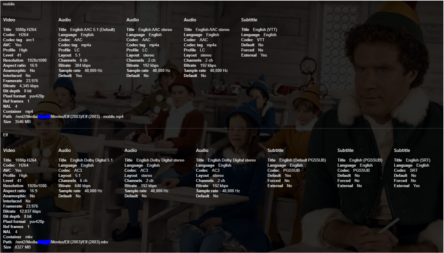

Q-Droid 1002 Posted August 30, 2019 Posted August 30, 2019 This file was just converted and now it's in the queue to be converted again. I noticed earlier after the upgrade that many of the old converted movies in this library were re-queued and had multiple converted versions with names like <movie> - mobile - mobile.mp4. I thought it might have been a DB or metadata issue so I cleaned it up, removed old conversions and created a new Convert job after removing the old "download". But the new job is still re-queuing movies after conversion.
Q-Droid 1002 Posted August 30, 2019 Posted August 30, 2019 More info: This is the kind of stuff I end up with in this library and the conversion is still running again for some of them. -rw-r--r--+ 1 emby video 3625260660 Aug 30 01:17 Elf (2003) - mobile - mobile.mp4 -rw-r--r--+ 1 emby video 3718641795 Aug 29 18:11 Elf (2003) - mobile.mp4 -rw-r--r--+ 1 emby video 5397247128 Aug 30 01:36 Fantastic Beasts The Crimes of Grindelwald (2018) - mobile - mobile.mp4 -rw-r--r--+ 1 emby video 5397335697 Aug 29 19:24 Fantastic Beasts The Crimes of Grindelwald (2018) - mobile.mp4 -rw-r--r--+ 1 emby video 4040397266 Aug 30 01:39 Halloween (2018) - mobile - mobile.mp4 -rw-r--r--+ 1 emby video 4074267893 Aug 29 19:40 Halloween (2018) - mobile.mp4 -rw-r--r--+ 1 emby video 2721776676 Aug 30 07:53 Invader ZIM Enter the Florpus (2019) - mobile - mobile.mp4 -rw-r--r--+ 1 emby video 2721776676 Aug 29 21:18 Invader ZIM Enter the Florpus (2019) - mobile.mp4 -rw-r--r--+ 1 emby video 5057274242 Aug 30 08:09 The Conjuring 2 (2016) - mobile - mobile - mobile.mp4 -rw-r--r--+ 1 emby video 5099215972 Aug 30 01:15 The Conjuring 2 (2016) - mobile - mobile.mp4 -rw-r--r--+ 1 emby video 5141642955 Aug 29 17:40 The Conjuring 2 (2016) - mobile.mp4 -rw-r--r--+ 1 emby video 7359208986 Aug 30 07:58 The Right Stuff (1983) - mobile - mobile.mp4 -rw-r--r--+ 1 emby video 7421268086 Aug 29 23:51 The Right Stuff (1983) - mobile.mp4
Q-Droid 1002 Posted August 30, 2019 Posted August 30, 2019 Any ideas about this? As it is now the Convert feature is not usable for media with multiple audio tracks. Let me know if more info is needed.
