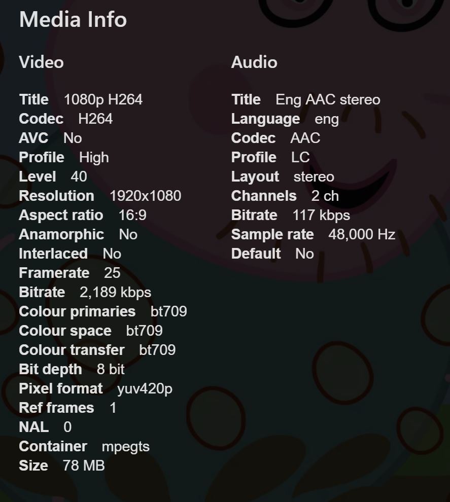

ebr 16338 Posted April 14, 2019 Posted April 14, 2019 Hi. Can you show us the specifics about one of these items (media info from web app)? Have you tried adjusting the deinterlacing setting in the app?
F1nchy 29 Posted April 15, 2019 Author Posted April 15, 2019 Hi ebr. I tried adjusting the settings in the Fire Emby app - turned deinterlacing on SD and HD content on (it was off), but it still didn't play. It kind of hung for a while (presumably whilst the server was deinterlacing it) but then it still did the same. I turned it back off again and it was still the same. When you say the media info from web app, where do I find that?
ebr 16338 Posted April 15, 2019 Posted April 15, 2019 Bring up the item in the web app and scroll to bottom:

ebr 16338 Posted April 18, 2019 Posted April 18, 2019 Well, not sure. Your sample plays perfectly for me on my Fire TV. On my Mi box, it doesn't crash but it doesn't play smoothly. For the first several seconds, the video is very choppy and then it lines out and is mostly okay.
