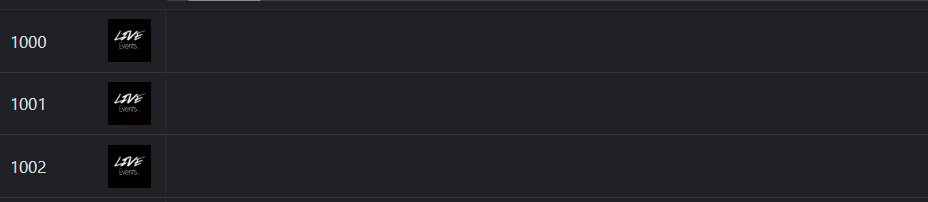

EODCrafter 181 Posted April 13, 2019 Author Posted April 13, 2019 (edited) It would be nice to show the name of the channel in the Guide....Hard to navigate without knowing channel name...As shown above it's blank It's no issue on the Server interface/browser but Emby apps can't hover over that name like that. BTW, you can't edit this M3U @@Luke, it gets updated several times a day @@Sammy Edited April 13, 2019 by EODCrafter 2

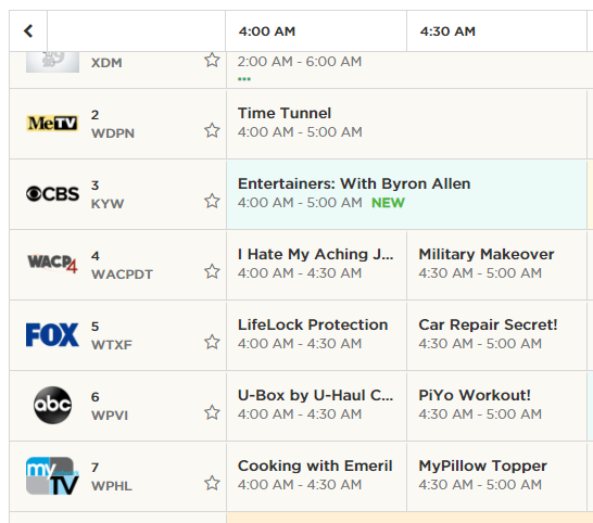

Carlo 4561 Posted April 14, 2019 Posted April 14, 2019 (edited) I figured it out...xTeVe @@marmei to the Rescue again! Marmei / xTeVe is Awesome! I used a m3u Grab/and some CUID (Unique ID) magic that auto updates every hour! That's exactly what I though you were after. That's cool as hell EODCrafter! Care to share your implementation? I'm sure this would be extremely helpful to many others as well. Where did you get the time from? Time wasn't in the original example you showed. PS I've made the same comment about needing the station/channel NAME to show as well in the grid. Something more like: Edited April 14, 2019 by cayars 1

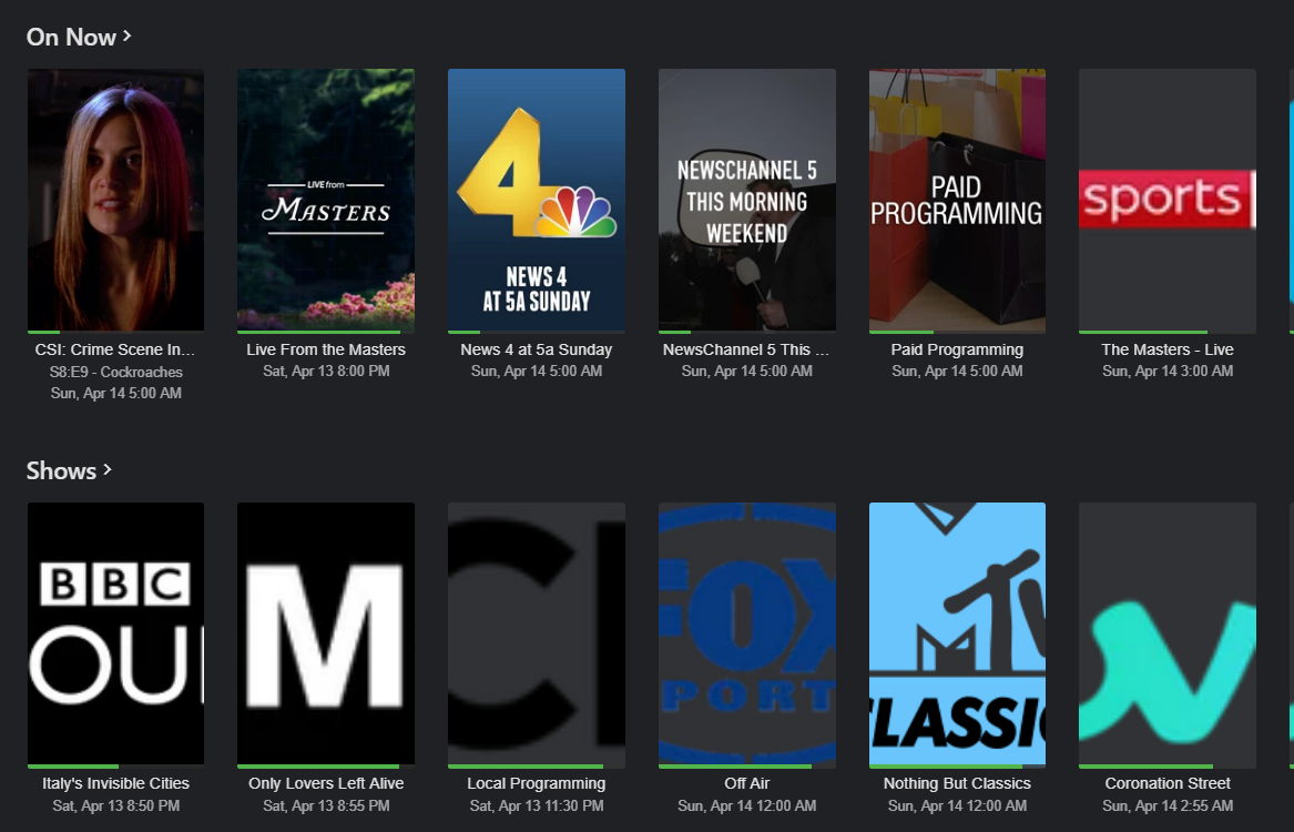

Carlo 4561 Posted April 14, 2019 Posted April 14, 2019 That looks good in the grid. Did you check to see if you are getting a bunch of duplicate entries in the PROGRAM section under Live TV yet? That's what worries me.
EODCrafter 181 Posted April 14, 2019 Author Posted April 14, 2019 Doesn't show anything under that because, I guess, it's not real Guide Data.....
