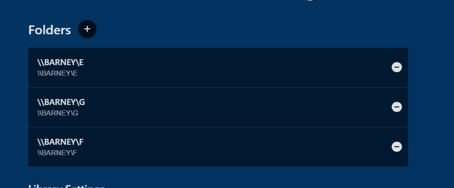

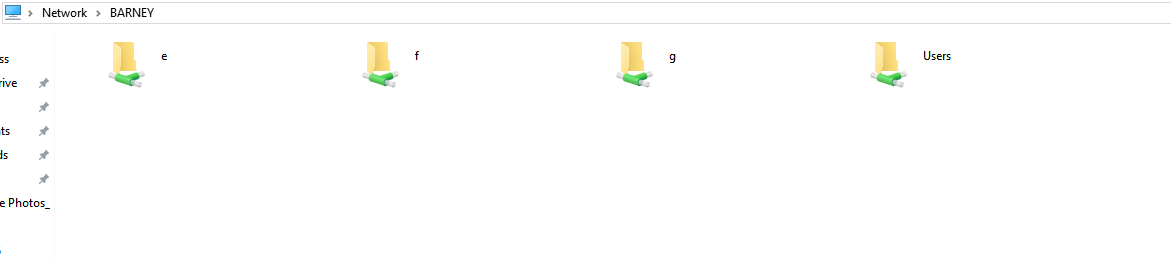

Rhino J Board 0 Posted April 10, 2019 Author Posted April 10, 2019 Hi there, what exactly is missing? Can you please go over an example? Thanks. So I have my emby server running on my living room machine name \\Betty, this also has my TV shows located on it \\Betty\E, \\Betty\F, \\Betty\G, \\Betty\H, \\Betty\I and \\Betty\J. And my movies are stored on theater room machine \\Barney and the movies are on drives \\Barney\E, Barney\F and Barney\G. from what I can tell it only appears to be movies from \\Barney|E that appear to be missing. All my TV Shows appear to be ok but now that i've read the below reply I may look further into it. From what you can tell is this just a networking issue? I can access \\Barney\drives from \\Betty so hence why it had me confused, maybe just a coincidence that it appeared to happen around same time as Emby server version update. does that help? Looks like your shares are going offline. 2019-04-09 10:56:24.025 Error LibraryMonitor: Error in Directory watcher for: \\Barney\e System.ComponentModel.Win32Exception: System.ComponentModel.Win32Exception (64): The specified network name is no longer available Source: TargetSite: No Stack Trace Available 2019-04-09 10:56:24.025 Error LibraryMonitor: Error in Directory watcher for: \\Barney\g System.ComponentModel.Win32Exception: System.ComponentModel.Win32Exception (64): The specified network name is no longer available Source: TargetSite: No Stack Trace Available Looks like permissions issue 2019-04-09 11:51:37.037 Error HttpServer: Error processing request System.UnauthorizedAccessException: System.UnauthorizedAccessException: Access to the path '\\10.0.0.2\e' is denied. You also have a issue with system folders as you appear to be using the root of the drive instead of a subfolder. 2019-04-09 10:56:37.339 Error App: Error resolving path \\BETTY\I\Recovery System.UnauthorizedAccessException: System.UnauthorizedAccessException: Access to the path '\\BETTY\I\Recovery' is denied. I assume there is a write permissions issue also as you have a couple metadata saving errors also. example 2019-04-09 12:11:39.983 Error ProviderManager: Error in metadata saver System.UnauthorizedAccessException: System.UnauthorizedAccessException: Access to the path '\\BETTY\E\FBI\Season 01\FBI S01E17.nfo' is denied. Not entirely sure what is going on here either. Line 8593: 2019-04-09 11:59:41.365 Info App: Removing item from database, Type: Folder, Name: , Path: \\Barney\e, Id: 105563 Line 8720: 2019-04-09 12:00:03.854 Info App: Removing item from database, Type: Folder, Name: , Path: \\Barney\g, Id: 103711 Line 8837: 2019-04-09 12:00:23.167 Info App: Removing item from database, Type: Folder, Name: , Path: \\Barney\f, Id: 103708
