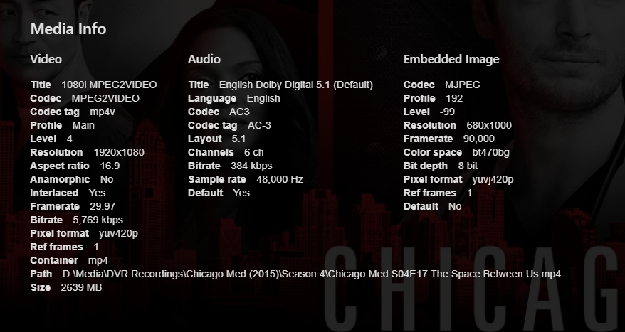

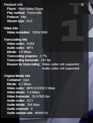

rfischman 1 Posted March 30, 2019 Author Posted March 30, 2019 Yep. Here's a screenshot of the media info.. Also attached the "Stats for nerds" screenshot when playing it back in the web player.
ebr 16338 Posted March 30, 2019 Posted March 30, 2019 The web player has to transcode this due to the video codec so that's why that is working. Ffmpeg is finding the audio track but the Android TV player does not see it at all.

rfischman 1 Posted March 30, 2019 Author Posted March 30, 2019 Will do. I'm using MCEBuddy to do the transcoding on the MPEG2 streams. The "Unprocessed" settings claim all they do is repackage video/audio into the MP4 container without touching the original audio or video source. And for comparison, here's the media info from the original MPEGTS container. the only difference I can see is the "Default" setting on the audio track. Will see if I can change that in MCEBuddy and see if it makes a difference. I'll try messing around with changing the audio track "default" setting and if that doesn't make a difference, I'll drop box you the original and converted. However, in looking at a file that I used a different conversion profile on (changes video to H 264 and Audio to AAC), it also has the default track flag set and works fine..
