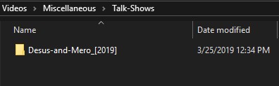

TheBrainninja 0 Posted March 26, 2019 Posted March 26, 2019 Hello, This has been an issue for a little while, though it seems like it's getting worse; some directories in my mixed-content libraries are entirely ignored - not just mis-detected, but completely absent. I'm able to add those folders in manually, and looking through the logs it lists "duplicate library path" or something similar. However, neither those directories nor their contents are anywhere to be found. I'm not sure if this started with version 4.0, but I'm on 4.0.2.0 now. For reference, despite repeated re-scanning, "Talk-Shows" never shows up in Emby: There are plenty other sub-directories in other folders that don't appear, but since there are relatively few sub-directories here it was a lot easier to finally recognize the issue. This is the top-level of my "Documentaries and Other" library. Thanks in advance for any help!

TheBrainninja 0 Posted March 27, 2019 Author Posted March 27, 2019 What is the contents of the talk-shows folder? Has this folder been added to any other emby library? Currently just one directory; it's a work in progress! That directory is not part of any other library. Also, I've verified the permissions on the directory: The "mediamanagers" group is one I created with myself and the "emby" user as members to give that service write permissions.

TheBrainninja 0 Posted May 4, 2019 Author Posted May 4, 2019 (edited) The latter, as we need to know complete paths of the content and probably what content is in these folders to possibly figure out why your having this issue. Ah, thanks for the clarification! An example file path in that library: /mnt/Media/Videos/Miscellaneous/Documentaries/Food-Inc_[2008]/Food-Inc_[2008].mkv A couple of TV Episodes: /mnt/Media/Videos/Miscellaneous/Documentaries/Surviving-R-Kelly_[2019]/Season-01/Surviving-R-Kelly_S01E01_The-Pied-Piper-of-R&B - 1080p.mkv /mnt/Media/Videos/Miscellaneous/Talk-Shows/Desus-and-Mero_[2019]/Season-01/Desus-&-Mero-(2019)_S01E01_Series-Premiere,-Ballbags - 720p.mkv Edited May 4, 2019 by TheBrainninja
