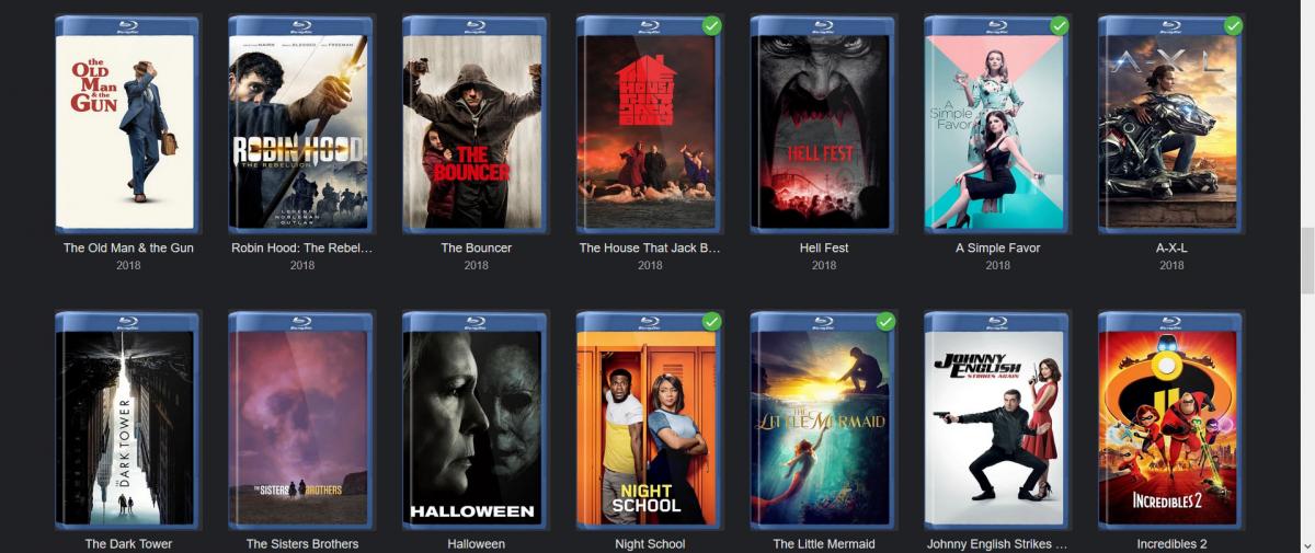

Pain 13 Posted March 23, 2019 Author Posted March 23, 2019 I don't no how else to explain it. Here in the attached ss you see the green checked showing only a few when I have seen them all. if I manually select/check watched on all of them it works, but as soon as I leave and come back they are unchecked. But sometimes not all of them are unchecked, thats why I say it seems random. My brother has the same exact problem on his firetv.

ebr 16313 Posted March 24, 2019 Posted March 24, 2019 Hi. Can we see more of the context of that screenshot? Where exactly is that? What view and what type of library?
Pain 13 Posted March 24, 2019 Author Posted March 24, 2019 (edited) @@ebr Here is a link to a video of what I am trying to explain. You will see in the video that some work like they should and most do not. Edited March 24, 2019 by Pain
ebr 16313 Posted March 25, 2019 Posted March 25, 2019 Thanks. Something is definitely not working right there...
