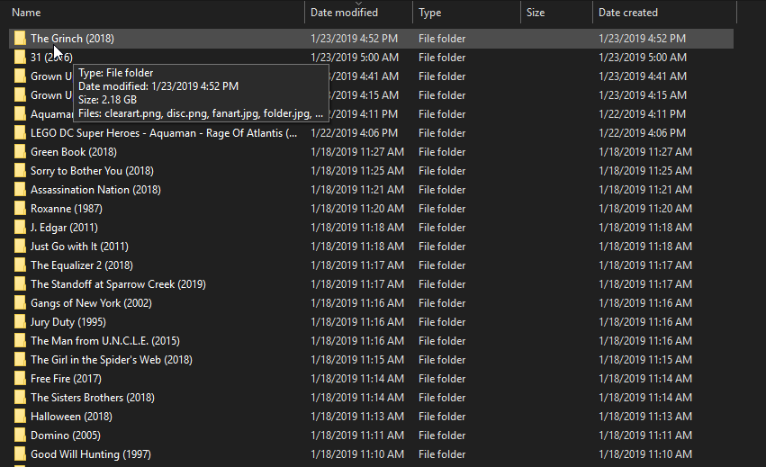

I've been having an ongoing issue within Windows 10 with my files and their created/modified date.
I can't pinpoint if it's Emby or Filebot, but wanted to at least see if I could get some clarification, and rule one or the other out.

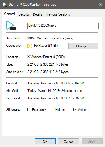

When I download anything that ends up in Emby, the file created and modified date are being shown as last year.
Windows 10 is displaying the correct time and date.
The dates are sequential. Meaning, today's date for me locally is, March 14 2019. Everything I download today will be shown as November 6 2018. Tomorrow it will show as November 7 2018 and so on.
This issue is not the end of the world by any means, but it is incredibly annoying if I try to sort by date in Windows. The last known accurate date was, January 23 2019. After that, "something" happened.

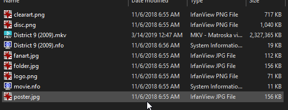

I'm attaching a few screenshots as well as my log. I just downloaded "District 9" (downloaded at 12:49:11am today) as to replicate this issue in the server log. If there's any other logs that can help, please reply with which to attach.
Here is the script that filebot uses:
filebot -script fn:amc --output "//192.168.86.2/Home" --action duplicate --conflict skip -non-strict --log-file amc.log --def excludeList=amc.excludes unsorted=y music=y artwork=y "ut_dir=%F" "ut_kind=multi" "ut_title=%N" "ut_label=%L"
The original files that download, have the correct date. It's when they are moved to their proper media folder that they obtain this false previous date, and then all metadata and artwork reflect the "fake date" as well.

The parent folder of the new media is created by Filebot, therefore the parent folder with the incorrect date which corresponds to the incorrect date of the nfo and artwork (created by Filebot also) points all issues back to.....Filebot.
