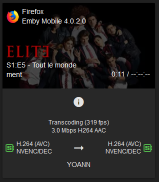

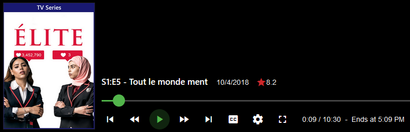

Okeur75 7 Posted March 11, 2019 Posted March 11, 2019 Hello guys, I searched on the forum but could not find anything regarding HLS subtitles causing error so here I am. Problem 1: I'm experiencing the famous "Playback error..." when watching some episodes. I took a look at the logs and it crashed because "HLS Subtitles are not supported for this media." The strange thing is that it happens only on 2 episodes (out of 8) even if the 8 seems to be encoded with the same settings and the same set of subtitles. Some info that may help: If I play the "faulty" episode without subtitles it works. If I play the "faulty" episode with whatever subtitles it fails. I can play the other episode with or without subtitles without any error. Exhibit 1 the logs (full logs attached) 2019-03-11 17:50:22.305 Error HttpServer: Error processing request *** Error Report *** Version: 4.0.2.0 Command line: /opt/emby-server/system/EmbyServer.dll -programdata /var/lib/emby -ffdetect /opt/emby-server/bin/ffdetect -ffmpeg /opt/emby-server/bin/ffmpeg -ffprobe /opt/emby-server/bin/ffprobe -restartexitcode 3 -updatepackage emby-server-deb_{version}_amd64.deb Operating system: Unix 4.9.0.8 64-Bit OS: True 64-Bit Process: True User Interactive: True Processor count: 6 Program data path: /var/lib/emby Application directory: /opt/emby-server/system System.ArgumentException: System.ArgumentException: HLS Subtitles are not supported for this media. at Emby.Server.MediaEncoding.Api.Hls.DynamicHlsService.Get(GetSubtitlePlaylist request) at Emby.Server.Implementations.Services.ServiceExecGeneral.GetTaskResult(Task task) at Emby.Server.Implementations.Services.ServiceHandler.ProcessRequestAsync(HttpListenerHost appHost, IRequest httpReq, IResponse httpRes, ILogger logger, String operationName, CancellationToken cancellationToken) at Emby.Server.Implementations.HttpServer.HttpListenerHost.RequestHandler(IRequest httpReq, String urlString, String host, String localPath, CancellationToken cancellationToken) Source: Emby.Server.MediaEncoding TargetSite: Void MoveNext() at Emby.Server.MediaEncoding.Api.Hls.DynamicHlsService.Get(GetSubtitlePlaylist request) at Emby.Server.Implementations.Services.ServiceExecGeneral.GetTaskResult(Task task) at Emby.Server.Implementations.Services.ServiceHandler.ProcessRequestAsync(HttpListenerHost appHost, IRequest httpReq, IResponse httpRes, ILogger logger, String operationName, CancellationToken cancellationToken) at Emby.Server.Implementations.HttpServer.HttpListenerHost.RequestHandler(IRequest httpReq, String urlString, String host, String localPath, CancellationToken cancellationToken) Exhibit 2 : The mediainfo from 2 episodes, the first one is working, the second one is not. Files attached. Problem 2:(probably linked to Problem 1 but if not I can make a separate thread) On the same faulty episode, when I play it without any subtitles, the progression time bar bugs, see screenshot below.(0:02/0:10) Few seconds later the lenght of the episode appears to be 10:30 On the dashboard page, the transcoding information are not shown as usual: Improvement idea: Last but not least, it seems there is no error recovery for this kind of situation. If we take the above example: I'm playing the "faulty" episode without any subtitles and it works I realise I need subtitles (because you know, french people don't speak english ). So I click on the CC icon and chose the first one -> It fails (blackscreen etc.) Ok nevermind I will watch it without any subtitles, so I click on the CC icon and change it back to "Off". I would expect it to work but it doesn't. I have to go back on the episode screen, and start again the episode. So to sum up: What do I need to do to play the faulty episode ? Is Problem 2 linked to Problem 1 ? Can this error recovery be implemented easily ? A lot of things in one thread, admins, do tell me if I need to split it. Regards, logs.txt faulty-episode.txt working-episode.txt
