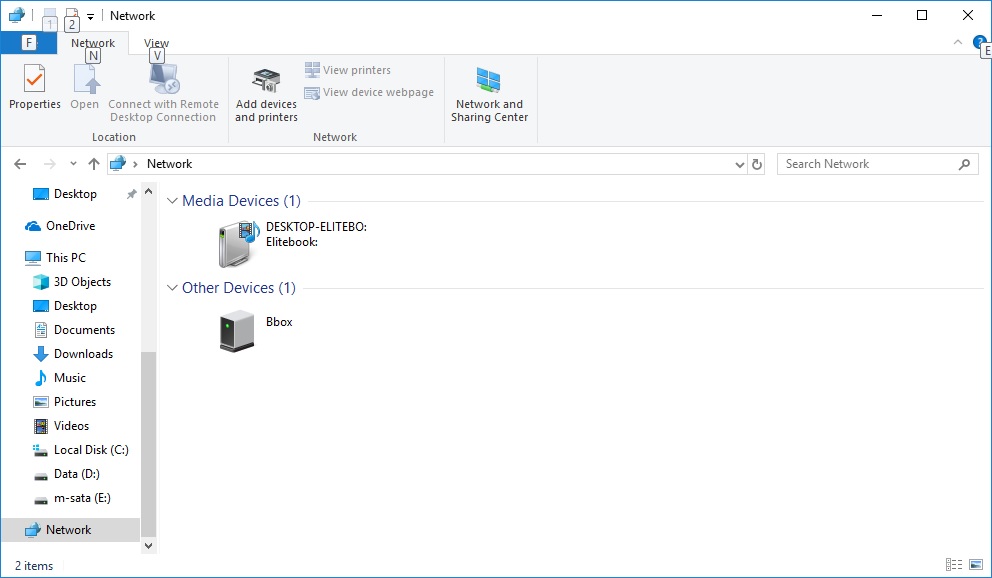

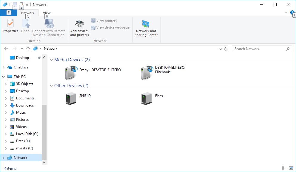

Birdy110 1 Posted March 11, 2019 Posted March 11, 2019 (edited) For few days it has been a nightmare trying to get Emby work with my windows 10. The server runs and it is accessible from other devices via ip address (browser). But when I try to access it via UPnP in Kodi on my Nvidia Shield the server is not detected and can't be accessed. I have tried everything: opening port 8096 in firewall (even router), adding emby directory to exeptions in antivirus program, totally disabling firewall, Un-installing Plex, and resetting windows network. But nothing seem to work! Suddenly Emby start working normally and the next time it will not! This is how my windows network looks when emby decide to work: If emby decide to make me happy, then it shows its Green emby icon. (This is not the case in this picture)! And this is when it will no longer work: On the same PC if I run Plex or Kodi , then they both show as network devices and are both accessible with no problem from my shield!!! I have been searching and trying everything for few days now with no result! So I thought it is time to ask for help! I have tried latest stable build and the two last beta versions with same result! (I have attached last server log) embyserver.txt Edited March 11, 2019 by Birdy110

Birdy110 1 Posted March 16, 2019 Author Posted March 16, 2019 (edited) The nightmare begins again! everything was working perfect for a day and suddenly Emby is again not discovered as UPnP. The only changes I have done : Installed: lav filtersmadvrpotplayerbeyond comparelatest nvidia driversccleaner (ccleaner cleared cookies and also this folder C:\Users\Elite\AppData\Local\Temp\) <--- can this be a problem?windows settings : do i need any background app to get emby working? (any privacy setting that could cause this?) I just installed Plex and it works perfect! Also installed kodi and UPnP server runs perfect! I have attached two logs. One when it work and one when it stopped working. Maybe someone could compare! Even if there was a problem on my side, isn't emby shaky and unreliable server when others can work in same environment? Edit: Another strange thing is when I get it working if I restart pc it will work again. But if I shutdown windows and then start the PC it will no longer work for sure! working.xml not working.xml Edited March 16, 2019 by Birdy110

Birdy110 1 Posted March 18, 2019 Author Posted March 18, 2019 Hi, as you can see in the forum we work very hard here to provide support. You just posted these last night. Thank you for your patience in allowing more time. This is not a problem posted last night! this is posted 8 days ago and you have not provided any helpful help or solution. Working hard is to fix users real problems and not only answer to some easy questions! Now let's get to the problem. As there is no one competent to identify it I have finally been able to find what is going on after wasting many hours. The server stop working correctly if you have Two or plus network adapters. In my case I have an Ethernet (Intel® 82579LM Gigabit Network Connection) and also a wifi (Intel® Centrino® Ultimate-N 6300 AGN). I am connected to internet via Ethernet connection. Now if you disable the wifi adapter the server (UPnP) problem is solved and it will start working normally. As explained before other servers like PLEX and KODI work without the need for disabling other adapters. So something in your code is broken and need to be fixed. At least add this on a known issue list for emby so other users don't struggle hours trying to find out what is wrong! This is minimum respect for people using you software. No need to mention that this problem is present for months now!
