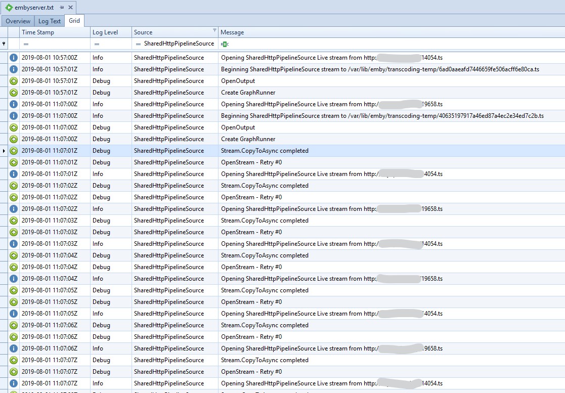

softworkz 5130 Posted August 2, 2019 Posted August 2, 2019 Thanks for the new log. I've found out that you're encountering the same problem as the user here: https://emby.media/community/index.php?/topic/74974-serious-recording-issues/?p=770736 In your case it's just the symptoms that are a little different (due to different IPTV provider probably).
softworkz 5130 Posted August 2, 2019 Posted August 2, 2019 To illustrate this, look at the following filtered view of your log: At 10:57, stream 14054 is opened There's no problem, not error with receiving that stream....until... 11:07 h: Stream 19658 is opened additionally At the same time (11:07:01) - the first stream is ended by the provider (CopyToAsync completed) Then the first stream is being retried and that is kicking out the second stream. From now on, both streams are fighting against each other::

softworkz 5130 Posted August 2, 2019 Posted August 2, 2019 thank you for your help trying to solve this issue. but i am not sure yet, why its happening - you mean, the first stream gets kicked and emby is trying to restart it all the time - and additionally trying to start a second stream? No. Emby starts a second stream and this causes the first stream to get kicked. For me, this sounds like an emby issue? One could think so that it's Emby's fault, e.g because Emby tries to reconnect too quickly... and there's some room for improvement on that side without doubt. But the problem is not originally caused by Emby. (actually I've explained that above already) We just need to look at how this all starts: Emby is consuming a stream Emby is establishing a second stream The first stream gets disconnected So what would Emby have done wrong here? It is a problem with your IPTV provider not allowing more streams. Currently Emby is fighting itself with the two stream requests playing ping-pong. The result of that ping-pong game are those non-working recordings that you're seeing. In the future we will fail recordings or live tv playback requests after a small number of retries. Emby should be able to handle some kind of "streaming issues" - it could happen anytime that the stream cuts off for a second, it should resume it as fast as possible in my view? The problem with TS streams via IPTV is that there doesn't exist something like "resume" for a stream. We can only re-open the stream but that doesn't mean that the data is continuing from where we stopped. In case of the other thread that I referenced, the server is always starting from 20s in the past. A stream can fail every now and then and we'll still try to re-open the stream - but only a limited number of times and if doesn't help, the recording is marked as failed. We won't run into those endless retry-loops anymore which had caused those invalid recordings. But effectively that means that - if it would happen again - you would get no recording instead of a corrupted recording. The underlying issue that you need to solve is about why your IPTV provider doesn't allow the additional stream?
xanthos84 1 Posted August 2, 2019 Posted August 2, 2019 (edited) No. Emby starts a second stream and this causes the first stream to get kicked. One could think so that it's Emby's fault, e.g because Emby tries to reconnect too quickly... and there's some room for improvement on that side without doubt. But the problem is not originally caused by Emby. (actually I've explained that above already) We just need to look at how this all starts: Emby is consuming a stream Emby is establishing a second stream The first stream gets disconnected So what would Emby have done wrong here? It is a problem with your IPTV provider not allowing more streams. Currently Emby is fighting itself with the two stream requests playing ping-pong. The result of that ping-pong game are those non-working recordings that you're seeing. In the future we will fail recordings or live tv playback requests after a small number of retries. The problem with TS streams via IPTV is that there doesn't exist something like "resume" for a stream. We can only re-open the stream but that doesn't mean that the data is continuing from where we stopped. In case of the other thread that I referenced, the server is always starting from 20s in the past. A stream can fail every now and then and we'll still try to re-open the stream - but only a limited number of times and if doesn't help, the recording is marked as failed. We won't run into those endless retry-loops anymore which had caused those invalid recordings. But effectively that means that - if it would happen again - you would get no recording instead of a corrupted recording. The underlying issue that you need to solve is about why your IPTV provider doesn't allow the additional stream? But the question is - why Emby opens a second stream? I know that my IPTV provider does not allow a second stream - so thats why I am using Emby exclusively for recording and NOT watching LIVE! And I keep watching exactly for not timing two programmes to record at the same time! + another thing: i entered <1> into the pvr setting of parallel streams - I guess emby is ignoring that setting? my fault: i forgot that i reinstalled emby some month ago, and I forgot to set this to 1 - it was one 3... which is a mistake of course. i changed it now to <1> ... and now I test again if I get some bad recordings again. because in your theory, it should not happen again now, correct? Edited August 2, 2019 by xanthos84
softworkz 5130 Posted August 2, 2019 Posted August 2, 2019 Yes, correct. If Emby would still open two streams simultaneously, then it would be clearly a bug in Emby. But if Emby would open just a single stream and you would still encounter the problem, then it's most likely that your IPTV credentials have been compromised. I'd need a new log after you changed that setting to check.
