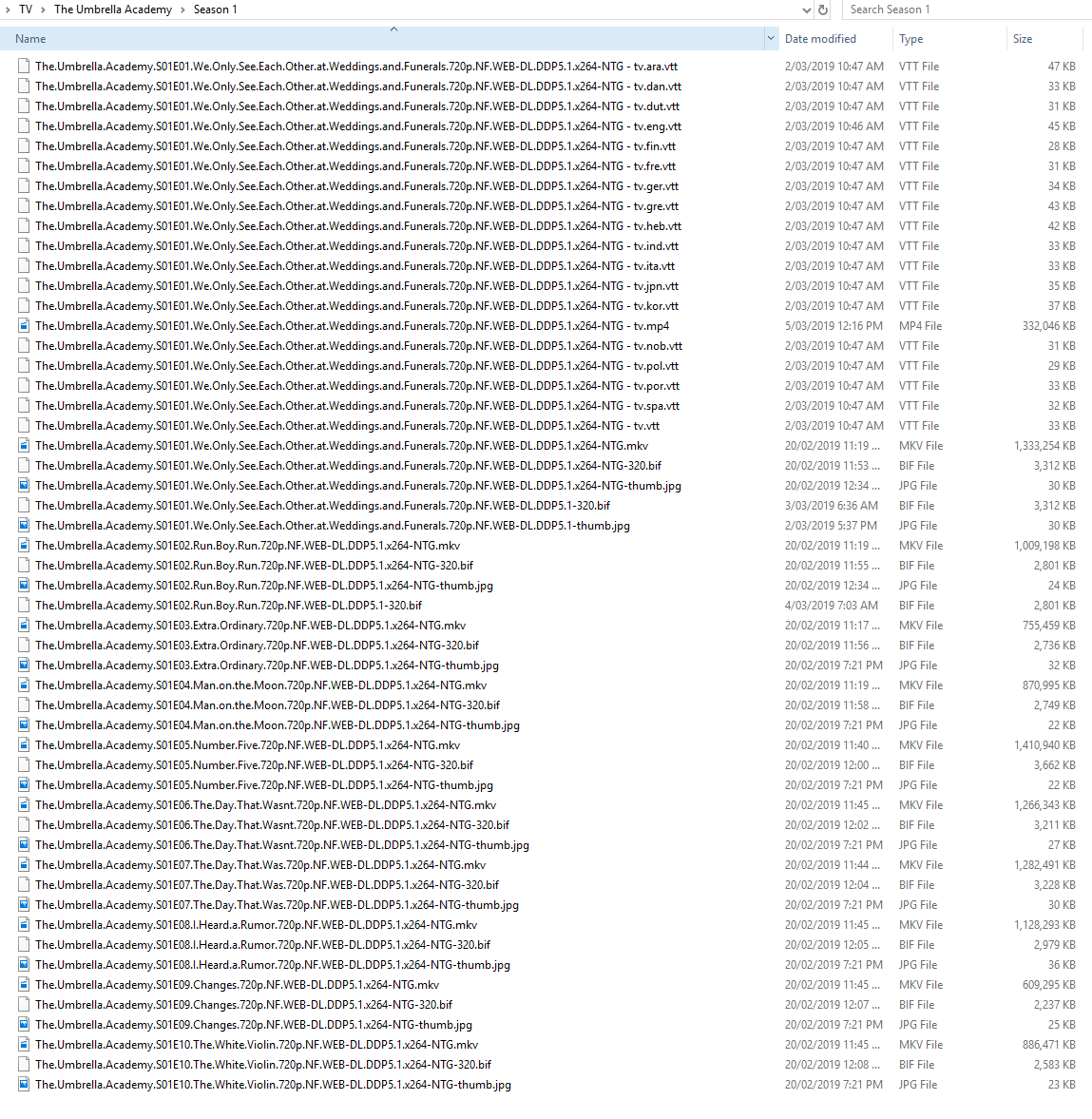

I wanted to add that in testing i created 2 separate conversions tasks that completed successfully each time. 2 different tv series - season 1 folders.
I then did another conversion task and added the original season 1 folder i attempted previously and the task is stuck at transferring again.
On the server I can see the converted files sitting in the local sync directory and the converted MP4 files play fine.
The dashboard shows the first ep is still stuck on Transferring and the local server folder shows the converted MP4 and the VTT files

5c7e1f01cfc6a_LocalServerFoldershowingEP
