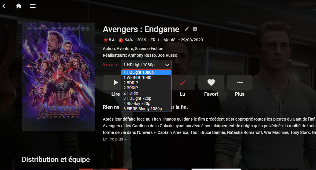

Nostromo86 17 Posted March 29, 2020 Posted March 29, 2020 Hi, it is possible to have alphabetical order for multiple version? Thanks
Luke 42213 Posted March 29, 2020 Posted March 29, 2020 I suppose, yes, although they are currently ranked on efficiency.
Nostromo86 17 Posted March 29, 2020 Posted March 29, 2020 I suppose, yes, although they are currently ranked on efficiency. Ok thank you, bellow my tests Here if i add quality one by one. the order is by add date He if add all my media in same time i have good order He if add all my media in same tape i have good order

Nostromo86 17 Posted March 29, 2020 Posted March 29, 2020 (edited) So you want your default order and would care less for the client choosing the most compatible version? So someone could hit play and be playing a version that could be transcoding every time do to Order? Users want order, users want to just hit play and Emby plays the proper version for their client/connection. This is where the Multi-version system is being used for something it was technically not designed for Resolution vs different Cuts/types 3d. Hello, I would like to have an alphabetical order like this. Like this my users when they launch the movie, will always have the best quality in 1 and if they want to change they can I use strm file. My user use android tv. and auto quality never works. like this Edited March 29, 2020 by Nostromo86
