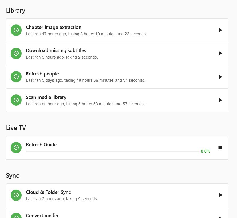

tp546 41 Posted March 9, 2019 Author Posted March 9, 2019 refresh guide never seems to end and why does everything else take so long?!?! there is clearly something wrong here. scan media library is set to run every 12 hours so that shouldn't be an issue. refresh guide is set to run every 24. @@ebr my old friend, any insight here? i am installing plex this weekend if we can't get this resolved because this is unbearable

tp546 41 Posted March 9, 2019 Author Posted March 9, 2019 I just killed the guide refresh and removed my tuners and all of a sudden everything is whipping around like normal again. @@Happy2Play thanks for the insight there - much appreciated. I'll try adding them back but that seems to be the root of the problem. Any additional insight is welcome here.
Luke 42221 Posted March 9, 2019 Posted March 9, 2019 To increase the performance of your server, please uninstall these plugins: Next Pvr 3.3.0.0 CoverArt 4.0.93.0 Thanks.
