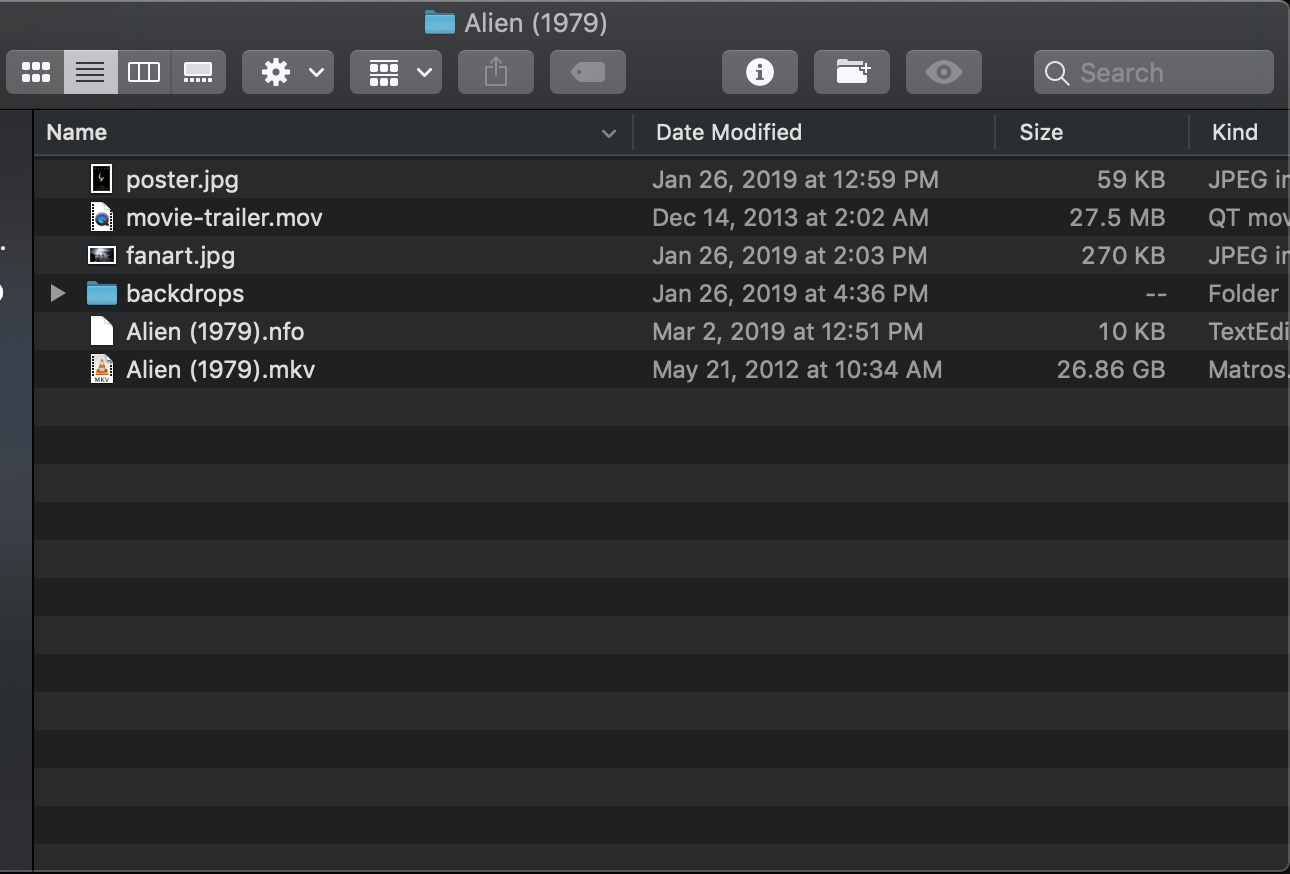

lockdown571 0 Posted March 4, 2019 Author Posted March 4, 2019 (edited) Can you give a specific example of how you have them named, assuming you haven't renamed them yet? Thanks. Hey Luke, not sure what you are asking. Like I said, ALL my movies trailers are named "movie-trailer". Each movie-trailer file is placed within the movie folder. So for instance there is a folder named Alien (1979). Within that folder are the files Alien (1979).mkv, Alien (1979).nfo, movie-trailer.mov, poster.jpg, fanart.jpg. I think the other reason why I used the generic 'movie-trailer' naming convention, is because Media Companion (which I used to use before switching to Emby for metadata management) by default named everything single trailer it downloaded 'movie-trailer'. Edited March 4, 2019 by lockdown571

Luke 42210 Posted March 4, 2019 Posted March 4, 2019 Ok yea that naming is not supported at this time.
