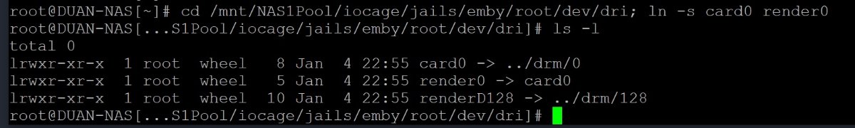

wmd1942 4 Posted January 5, 2021 Posted January 5, 2021 I have followed every direction mentioned here but without success. I'd appreciate if anyone can help me to figure out why. The emby server is installed as plugin in Truenas (12.0-U1). The CPU is i5-4690K, which has integrated Graphics 4600. Both drm and dri are exposed to emby jail. I downloaded "sys.xz" provided by Duffyx and decompressed it in root directory. My first problem is that the symlink of render0 to card0 does not get created by the post init script: After emby is running, I manually executed the same commands and the symlink will be created successfully: The 2nd symlink has been created in "sys.xz" provided by Duffyx: For some reason, the hardware was not detected: Here is the output from "vainfo": root@emby:/usr/local/lib/emby-server/bin # vainfo error: XDG_RUNTIME_DIR not set in the environment. error: can't connect to X server! libva info: VA-API version 1.10.0 libva info: Trying to open /usr/local/lib/dri/iHD_drv_video.so libva info: Found init function __vaDriverInit_1_10 libva error: /usr/local/lib/dri/iHD_drv_video.so init failed libva info: va_openDriver() returns 1 libva info: Trying to open /usr/local/lib/dri/i965_drv_video.so libva info: Found init function __vaDriverInit_1_10 libva info: va_openDriver() returns 0 vainfo: VA-API version: 1.10 (libva 2.10.0) vainfo: Driver version: Intel i965 driver for Intel(R) Haswell Desktop - 2.4.1 vainfo: Supported profile and entrypoints VAProfileMPEG2Simple : VAEntrypointVLD VAProfileMPEG2Simple : VAEntrypointEncSlice VAProfileMPEG2Main : VAEntrypointVLD VAProfileMPEG2Main : VAEntrypointEncSlice VAProfileH264ConstrainedBaseline: VAEntrypointVLD VAProfileH264ConstrainedBaseline: VAEntrypointEncSlice VAProfileH264Main : VAEntrypointVLD VAProfileH264Main : VAEntrypointEncSlice VAProfileH264High : VAEntrypointVLD VAProfileH264High : VAEntrypointEncSlice VAProfileH264MultiviewHigh : VAEntrypointVLD VAProfileH264MultiviewHigh : VAEntrypointEncSlice VAProfileH264StereoHigh : VAEntrypointVLD VAProfileH264StereoHigh : VAEntrypointEncSlice VAProfileVC1Simple : VAEntrypointVLD VAProfileVC1Main : VAEntrypointVLD VAProfileVC1Advanced : VAEntrypointVLD VAProfileNone : VAEntrypointVideoProc VAProfileJPEGBaseline : VAEntrypointVLD Here is the output when accessing the node and use it with the ffmpeg:
wmd1942 4 Posted January 5, 2021 Posted January 5, 2021 Never mind. I got it working. As I mentioned previously, the symlink of render0 to card0 does not get created by the post init script. I moved these commands into jail's exec_poststart as Duffyx did. It did the trick. Now, the transcoding page of emby is showing the hardware options for both encoders and decoders. However, I don't know why H.265 option is not shown. Also, I encoded a sample video file with and without hardware option but find out there is no difference on performance. I wonder what I missed. With hardware option, the encoding time is 34.76s (17.26 fps): root@emby:/tmp # su -m emby -c "/usr/local/lib/emby-server/bin/ffmpeg -vaapi_device /dev/dri/renderD128 -i 00138.MTS -c:v libx265 -an -x265-params crf=25 test_hw.mp4" ffmpeg version 4.3.0-emby_2020_05_23 Copyright (c) 2000-2019 the FFmpeg developers and softworkz for Emby LLC built with FreeBSD clang version 8.0.1 (tags/RELEASE_801/final 366581) (based on LLVM 8.0.1) Execution Date: 2021-01-05 10:23:35 [AVHWDeviceContext @ 0x805932200] libva: /usr/local/lib/dri/iHD_drv_video.so init failed Input #0, mpegts, from '00138.MTS': Duration: 00:00:10.02, start: 0.568567, bitrate: 24389 kb/s Program 1 Stream #0:0[0x1011]: Video: h264 (High) (HDMV / 0x564D4448), yuv420p(progressive), 1920x1080 [SAR 1:1 DAR 16:9], Level 42, 59.94 fps, 59.94 tbr, 90k tbn, 119.88 tbc, Start-Time 0.602s Stream #0:1[0x1100]: Audio: ac3 (AC-3 / 0x332D4341), 48000 Hz, stereo, fltp, 256 kb/s, Start-Time 0.569s Stream #0:2[0x1200]: Subtitle: hdmv_pgs_subtitle ([144][0][0][0] / 0x0090), 1920x1080, Start-Time 0.569s Stream mapping: Stream #0:0 -> #0:0 (h264 (native) -> hevc (libx265)) Press [q] to stop, [?] for help x265 [info]: HEVC encoder version 0.0 x265 [info]: build info [FreeBSD][clang 8.0.1][64 bit] 8bit+10bit+12bit x265 [info]: using cpu capabilities: MMX2 SSE2Fast LZCNT SSSE3 SSE4.2 AVX FMA3 BMI2 AVX2 x265 [info]: Main profile, Level-4.1 (Main tier) x265 [info]: Thread pool created using 4 threads x265 [info]: Slices : 1 x265 [info]: frame threads / pool features : 2 / wpp(17 rows) x265 [info]: Coding QT: max CU size, min CU size : 64 / 8 x265 [info]: Residual QT: max TU size, max depth : 32 / 1 inter / 1 intra x265 [info]: ME / range / subpel / merge : hex / 57 / 2 / 3 x265 [info]: Keyframe min / max / scenecut / bias : 25 / 250 / 40 / 5.00 x265 [info]: Lookahead / bframes / badapt : 20 / 4 / 2 x265 [info]: b-pyramid / weightp / weightb : 1 / 1 / 0 x265 [info]: References / ref-limit cu / depth : 3 / off / on x265 [info]: AQ: mode / str / qg-size / cu-tree : 2 / 1.0 / 32 / 1 x265 [info]: Rate Control / qCompress : CRF-25.0 / 0.60 x265 [info]: tools: rd=3 psy-rd=2.00 early-skip rskip mode=1 signhide tmvp x265 [info]: tools: b-intra strong-intra-smoothing lslices=6 deblock sao Output #0, mp4, to 'test_hw.mp4': Metadata: encoder : Lavf58.35.100 Stream #0:0: Video: hevc (libx265) (hev1 / 0x31766568), yuv420p, 1920x1080 [SAR 1:1 DAR 16:9], q=2-31, 59.94 fps, 60k tbn, 59.94 tbc Metadata: encoder : Lavc58.62.100 libx265 Side data: cpb: bitrate max/min/avg: 0/0/0 buffer size: 0 vbv_delay: N/A frame= 600 fps= 17 q=-0.0 Lsize= 8569kB time=00:00:09.95 bitrate=7024.3kbits/s throttle=off speed=0.287x video:8558kB audio:0kB subtitle:0kB other streams:0kB global headers:2kB muxing overhead: 0.122824% Last message repeated 1 times EXIT x265 [info]: frame I: 3, Avg QP:26.98 kb/s: 40753.65 x265 [info]: frame P: 151, Avg QP:28.21 kb/s: 17722.07 x265 [info]: frame B: 446, Avg QP:34.55 kb/s: 3145.68 x265 [info]: Weighted P-Frames: Y:14.6% UV:10.6% x265 [info]: consecutive B-frames: 1.3% 0.6% 36.4% 30.5% 31.2% encoded 600 frames in 34.76s (17.26 fps), 7002.11 kb/s, Avg QP:32.92 Without hardware option, the encoding time is 34.56s (17.36 fps): root@emby:/tmp # su -m emby -c "/usr/local/lib/emby-server/bin/ffmpeg -i 00138.MTS -c:v libx265 -an -x265-params crf=25 test_sw.mp4" ffmpeg version 4.3.0-emby_2020_05_23 Copyright (c) 2000-2019 the FFmpeg developers and softworkz for Emby LLC built with FreeBSD clang version 8.0.1 (tags/RELEASE_801/final 366581) (based on LLVM 8.0.1) Execution Date: 2021-01-05 10:20:53 Input #0, mpegts, from '00138.MTS': Duration: 00:00:10.02, start: 0.568567, bitrate: 24389 kb/s Program 1 Stream #0:0[0x1011]: Video: h264 (High) (HDMV / 0x564D4448), yuv420p(progressive), 1920x1080 [SAR 1:1 DAR 16:9], Level 42, 59.94 fps, 59.94 tbr, 90k tbn, 119.88 tbc, Start-Time 0.602s Stream #0:1[0x1100]: Audio: ac3 (AC-3 / 0x332D4341), 48000 Hz, stereo, fltp, 256 kb/s, Start-Time 0.569s Stream #0:2[0x1200]: Subtitle: hdmv_pgs_subtitle ([144][0][0][0] / 0x0090), 1920x1080, Start-Time 0.569s Stream mapping: Stream #0:0 -> #0:0 (h264 (native) -> hevc (libx265)) Press [q] to stop, [?] for help x265 [info]: HEVC encoder version 0.0 x265 [info]: build info [FreeBSD][clang 8.0.1][64 bit] 8bit+10bit+12bit x265 [info]: using cpu capabilities: MMX2 SSE2Fast LZCNT SSSE3 SSE4.2 AVX FMA3 BMI2 AVX2 x265 [info]: Main profile, Level-4.1 (Main tier) x265 [info]: Thread pool created using 4 threads x265 [info]: Slices : 1 x265 [info]: frame threads / pool features : 2 / wpp(17 rows) x265 [info]: Coding QT: max CU size, min CU size : 64 / 8 x265 [info]: Residual QT: max TU size, max depth : 32 / 1 inter / 1 intra x265 [info]: ME / range / subpel / merge : hex / 57 / 2 / 3 x265 [info]: Keyframe min / max / scenecut / bias : 25 / 250 / 40 / 5.00 x265 [info]: Lookahead / bframes / badapt : 20 / 4 / 2 x265 [info]: b-pyramid / weightp / weightb : 1 / 1 / 0 x265 [info]: References / ref-limit cu / depth : 3 / off / on x265 [info]: AQ: mode / str / qg-size / cu-tree : 2 / 1.0 / 32 / 1 x265 [info]: Rate Control / qCompress : CRF-25.0 / 0.60 x265 [info]: tools: rd=3 psy-rd=2.00 early-skip rskip mode=1 signhide tmvp x265 [info]: tools: b-intra strong-intra-smoothing lslices=6 deblock sao Output #0, mp4, to 'test_sw.mp4': Metadata: encoder : Lavf58.35.100 Stream #0:0: Video: hevc (libx265) (hev1 / 0x31766568), yuv420p, 1920x1080 [SAR 1:1 DAR 16:9], q=2-31, 59.94 fps, 60k tbn, 59.94 tbc Metadata: encoder : Lavc58.62.100 libx265 Side data: cpb: bitrate max/min/avg: 0/0/0 buffer size: 0 vbv_delay: N/A frame= 600 fps= 17 q=-0.0 Lsize= 8569kB time=00:00:09.95 bitrate=7024.3kbits/s throttle=off speed=0.289x video:8558kB audio:0kB subtitle:0kB other streams:0kB global headers:2kB muxing overhead: 0.122824% Last message repeated 1 times EXIT x265 [info]: frame I: 3, Avg QP:26.98 kb/s: 40753.65 x265 [info]: frame P: 151, Avg QP:28.21 kb/s: 17722.07 x265 [info]: frame B: 446, Avg QP:34.55 kb/s: 3145.68 x265 [info]: Weighted P-Frames: Y:14.6% UV:10.6% x265 [info]: consecutive B-frames: 1.3% 0.6% 36.4% 30.5% 31.2% encoded 600 frames in 34.56s (17.36 fps), 7002.11 kb/s, Avg QP:32.92
