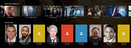

Guest Posted February 26, 2019 Posted February 26, 2019 Kind of a weird one guys, so I am able to see metadata for the main cast & crew of movies and tv shows in my library. However, when i go in an individual episode of a tv show (any tv show) the only cast & crew i see are of people that already are part of the main cast of a tv show or movie that is in my library. Am i missing some setting or maybe is this by design? Thanks in advance for all your help.

rbjtech 5338 Posted February 28, 2019 Posted February 28, 2019 (edited) Yea, it will pick up a couple of people too for me in some episodes but always most are faceless. I have noticed by clicking on those that appear that are only appearing because they are part of the main cast of another show or movie, so it seems it isn't refreshing metadata on the episode guest start level, only if manually requested for each guest star. I have refreshed metadata for series, individual episodes, whole libraries even numerous times. I agree with this behaviour - if the 'Guest Stars' appear anywhere in other films or TV series as main actors, then they are displayed at 'Episode' level as well. A manual refresh per Actor (at Episode level) will correctly get and save the details and be available for all future uses - so it appears the problem is Emby is just not automatically scraping the Guest Stars at this level from either the scheduled methods, or even 'Series' metadata refresh. The unscraped Actors do look ugly on an otherwise well designed screen (worse on most clients as they are multi-coloured bright rectangles..) - so my preference would actually be to have a dark ' silhouette' with just their name - rather than a 'obvious' missing item. As an example ... Example of how ugly the unscraped 'Guest Stars' are from the Web Client .. Edited February 28, 2019 by rbjtech

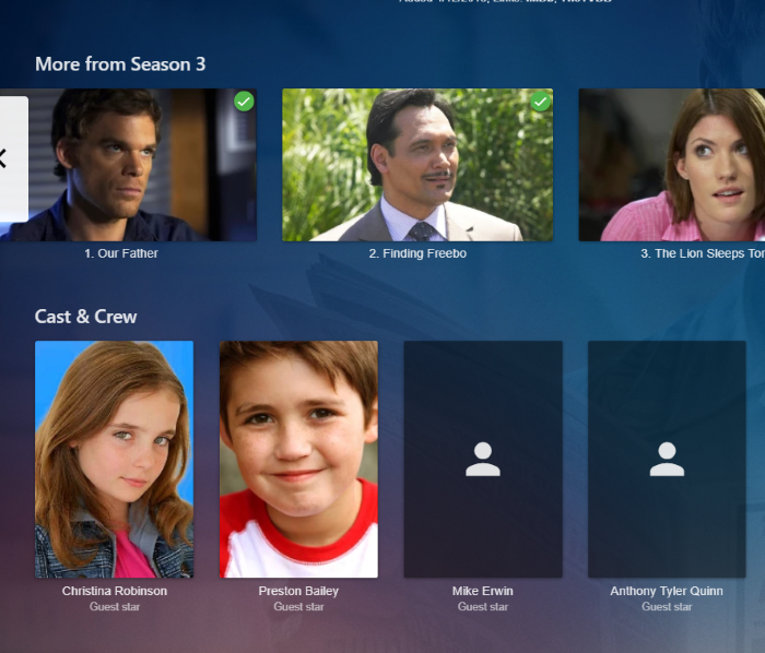

Luke 42217 Posted March 3, 2019 Posted March 3, 2019 Sorry i think i misunderstood this issue. Yes it is sometimes expected behavior due to the way the tvdb api works. The episode metadata from tvdb lists actor names only, no image urls. The series data gives both. That means if the actor is also not listed as part of the series, then we will not have an image url.
Guest Posted March 4, 2019 Posted March 4, 2019 Great, thanks for clarifying, in that case, possibly an option to hide image placeholders (or remove images all together like tvdb does) on the episode guest star level would be optimal.
