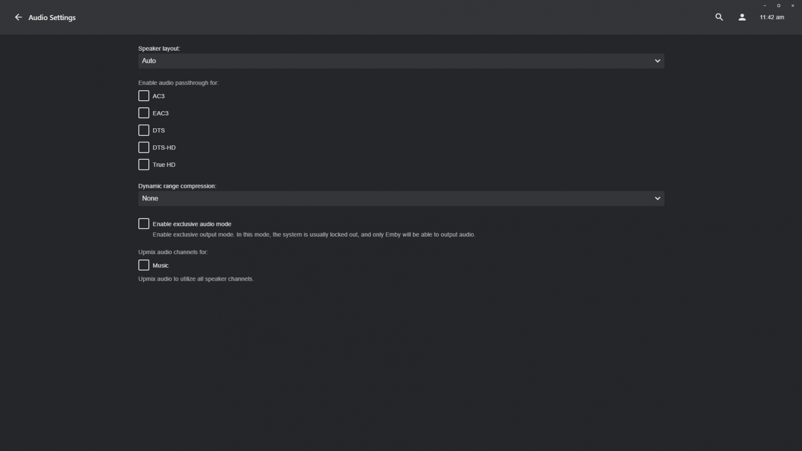

Guest asrequested Posted February 26, 2019 Posted February 26, 2019 I'll test it, later. How do you have your audio configured in Theater? A screenshot would be helpful.
Guest asrequested Posted February 27, 2019 Posted February 27, 2019 (edited) Just a quick test in mpv, results in stereo. [ 0.683][v][ao/wasapi] Disabling multichannel output. [ 0.683][v][ao/wasapi] Channel layouts: [ 0.683][v][ao/wasapi] - stereo [ 0.683][v][ao/wasapi] - 5.1 [ 0.683][v][ao/wasapi] - 7.1 [ 0.683][v][ao/wasapi] - 4.0 [ 0.683][v][ao/wasapi] - quad [ 0.683][v][ao/wasapi] - 5.1(side) [ 0.683][v][ao/wasapi] - 7.1(wide) [ 0.683][v][ao/wasapi] result: stereo [ 0.683][v][ao/wasapi] Accepted as stereo s32 @ 48000hz -> stereo s32 (32/24 bits) @ 48000hz (exclusive) [ 0.700][d][ao/wasapi] Init wasapi done [ 0.700][v][ao/wasapi] device buffer: 480 samples. [ 0.700][v][ao/wasapi] using soft-buffer of 9600 samples. [ 0.700][i][cplayer] AO: [wasapi] 48000Hz stereo 2ch s32 [ 0.700][v][cplayer] AO: Description: Windows WASAPI audio output (event mode) [ 0.700][d][osc] osc_init [ 0.700][v][autoconvert] inserting resampler [ 0.700][v][swresample] format change, reinitializing resampler [ 0.700][v][swresample] 48000Hz 5.0 floatp -> 48000Hz stereo s32 [ 0.700][v][swresample] Remix: 5.0 -> stereo [ 0.701][v][af] [out] 48000Hz stereo 2ch s32 I need to know how you've configured Theater's audio, to be able try and figure out what's happening. Edited February 27, 2019 by Doofus
flippyfingw 0 Posted February 27, 2019 Author Posted February 27, 2019 My speaker layout was set to auto, which had gave me those issues, changed to stereo and everything works fine now. Adding screenshots anyway. Might be an issue on my end with audio device configuration. Thanks for the help :-)
Luke 42217 Posted February 27, 2019 Posted February 27, 2019 Yea mpv docs actually suggest to always explicitly set the speaker layout rather than leaving it on auto.
