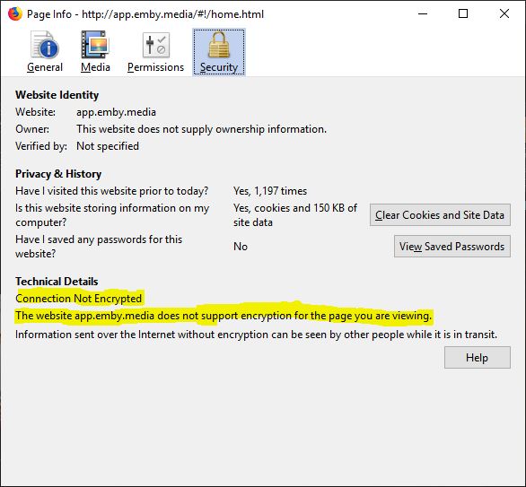

deme74 2 Posted February 25, 2019 Posted February 25, 2019 Hi I have my server set to require SSL for remote connection and only the secured port is forwarded by my firewall. However, when using Emby Connect the browser is using an unsecured connection (see image). What am I missing?
ebr 16313 Posted February 25, 2019 Posted February 25, 2019 Hi. That's the online web app as opposed to Connect (which is just an easy way to find your server). If you want to use SSL, Then you need to go to https://app.emby.media and log in. Or, just your direct domain name.

deme74 2 Posted February 25, 2019 Author Posted February 25, 2019 Thanks for the reply. I got there by pressing sign in on the Emby home page which is opening an unsecure page. In know I can go directly to my server, also the link you provided is OK, my question was how could an unsecured connection be made to a server which is set up correctly and should accept only secured connections?
deme74 2 Posted February 25, 2019 Author Posted February 25, 2019 No. You need a proper SSL setup on your end but you don't necessarily have to purchase a cert (there are free options). It is set up properly, with a Let'sEncrypt certificate. If I use your link or go directly to the server all is fine and with a green sign on the browser.

deme74 2 Posted February 25, 2019 Author Posted February 25, 2019 (edited) I can access my server directly via https with no problems on port 8920 which is forwarded by my firewall. If i try http on port 8096 it will not work as the firewall will block it. Also the Emby server is set to require secure connection for all remote connections. So how come I can connect unsecurely via EmbyConnect? Edited February 25, 2019 by deme74
CChris 59 Posted February 25, 2019 Posted February 25, 2019 Okey.I've just checked the "app.emby.media" This seems to be a "portal" or "gateway" provided by emby.media itself, which is then redirecting to the server which are registered to your emby online account. I never noticed this possibility until now - I am only using my own URL for connecting to my Emby Server.
deme74 2 Posted February 25, 2019 Author Posted February 25, 2019 I’m new at Emby and I’m used with the Plex online login so this is why I stumbled upon it [emoji3] Still, the question remains. How come an insecure connection can be made to a server which should not allow insecure connections? Sent from my iPhone using Tapatalk
Luke 42217 Posted February 25, 2019 Posted February 25, 2019 I’m new at Emby and I’m used with the Plex online login so this is why I stumbled upon it [emoji3] Still, the question remains. How come an insecure connection can be made to a server which should not allow insecure connections? Sent from my iPhone using Tapatalk The check is only against the protocol. If you have setup ssl you can now use the https version of the online web app.
deme74 2 Posted February 25, 2019 Author Posted February 25, 2019 So, if I’m getting this right, the http version of the web app is working even if the server is configured for SSL only? Sent from my iPhone using Tapatalk
ebr 16313 Posted February 25, 2019 Posted February 25, 2019 It is impossible for us to bypass the SSL requirement if that is how you have configured it on your end. The screen you brought up is just looking at the url and seeing "http" and, therefore, assuming an insecure connection.
deme74 2 Posted February 25, 2019 Author Posted February 25, 2019 Sorry, web servers are not my area of expertise. So basically it’s reported incorrectly as insecure by the browser although the connection is using SSL? Sent from my iPhone using Tapatalk
CChris 59 Posted February 25, 2019 Posted February 25, 2019 basically, the page "app.emby.media" is not ssl secured.But this is not based to your server-settings, since it is not your server...this page is part of the "emby.media" domain... and using your "community" login to connect to your profile - where you can then - select your server.This part should be secured if you have enabled ssl and using a valid certificate for your browser. But since the Address is still pointed to app.emby.media the browser is showing an unsecure connection.That's what I understood after realizing, that there is such an option^^
deme74 2 Posted February 25, 2019 Author Posted February 25, 2019 That would be my understanding as well. However, I consider the unencrypted connection between the browser and the app a potential vulnerability and perhaps it’s a good idea to default the link from the Emby home to the https version of the web app unless there is a strong motivation to keep the http as default. If someone prefers to not use https then they can use a direct link to their server. The importance of secure connections cannot be stressed enough these days and I believe Emby should offer only secure connection on their website. It’s better to stay of the safe side. Sent from my iPhone using Tapatalk
