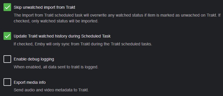

Angus Black 5 Posted February 24, 2019 Posted February 24, 2019 My Trakt settings in Plex; There is really nothing special about the settings. After you save the settings. Open Track in Plex (on the server). Choose Sync, then scroll top the bottom and select Push All to Track.tv. This will push your current Shows, Movies and watch states to your Trakt account.
Angus Black 5 Posted February 24, 2019 Posted February 24, 2019 In Emby you just have to make sure you are connected to the same Trakt account. You can also exclude libraries. Home videos for example. Here are my other Emby Trakt settings. Set up a Trakt Scheduled task to Pull Playstates from Trakt.tv. I scheduled it to run every hour. Run it manually the first time. You don't have to sync the Emby library to Trakt if you're using the same libraries as you are in Plex.

WeWillSee 2 Posted April 24, 2024 Posted April 24, 2024 On 2/24/2019 at 12:55 PM, Angus Black said: In Emby you just have to make sure you are connected to the same Trakt account. You can also exclude libraries. Home videos for example. Here are my other Emby Trakt settings. Set up a Trakt Scheduled task to Pull Playstates from Trakt.tv. I scheduled it to run every hour. Run it manually the first time. You don't have to sync the Emby library to Trakt if you're using the same libraries as you are in Plex. How do you run this manually I created trakt account out in the pin Emby but nothing seems to happen ?
