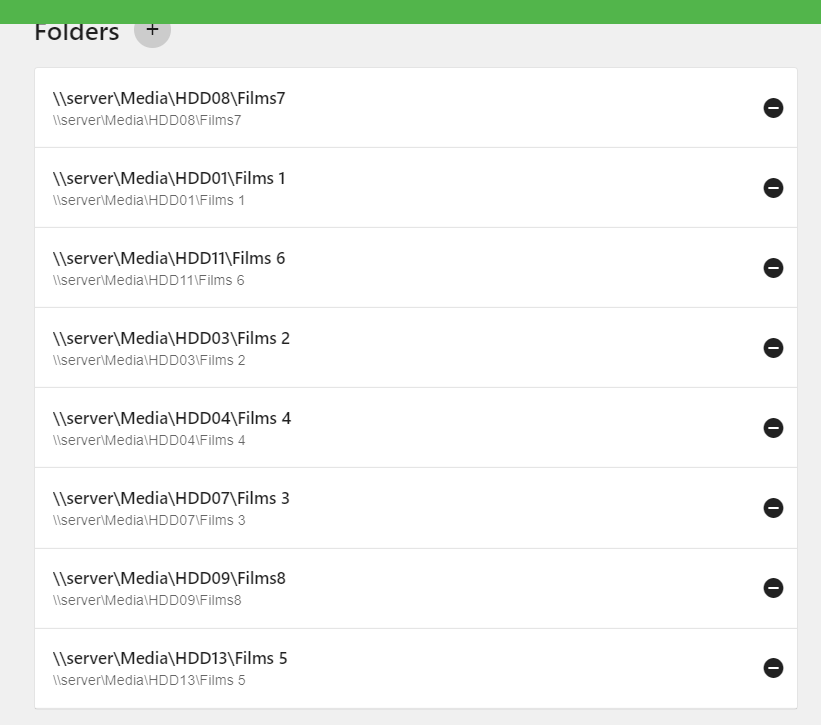

rbjtech 5337 Posted March 5, 2019 Posted March 5, 2019 (edited) On your library settings - are you saving the metadata local to the Emby installation - the default, or have you ticked the box to store the metadata in the media folders (on the 'media' machine) ? If saving the metadata local (default) there is no reason at all that the folders need to be read/write - all mine are set to Read Only using a service account - so I know that works perfectly fine. If on the Emby 'server' you can type the UNC path and 'see' the remote media (and execute/play it if required) then there is zero reason why Emby cannot do the same - as that is exactly what the library scan is doing .. Hmmm, interesting one. perhaps check the library settings again - Movies vs all the others to see if anything is different ? Attached is how my Library paths look as an example. Edited March 5, 2019 by rbjtech
