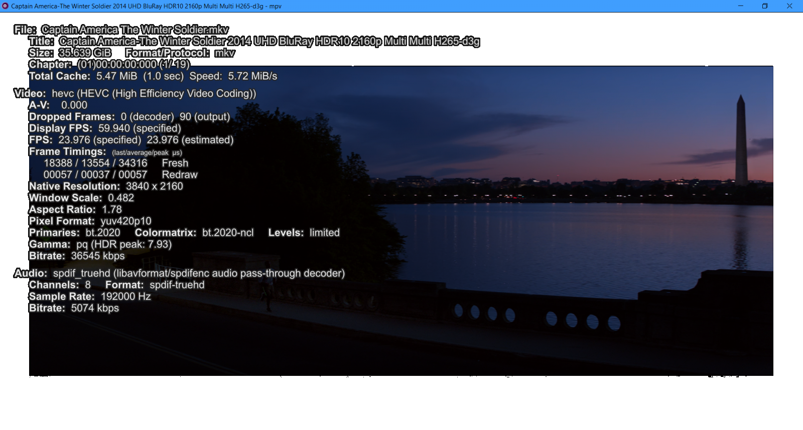

Disturbd1 2 Posted May 12, 2019 Author Posted May 12, 2019 Add this line to the mpv.conf, and try again. hwdec-codecs=all Same. Attached screen and the conf file in case I missed something. mpv.zip

Disturbd1 2 Posted May 12, 2019 Author Posted May 12, 2019 Try this gpu-api=auto hwdec=d3d11va hwdec-codecs=all audio-spdif=ac3,eac3,dts,dts-hd,truehd audio-exclusive=yes log-file="mpv log.txt" We're making progress, as it's now showing that it's using HEVC, but FR is not holding steady. It's smooth for a bit, then choppy again.
Guest asrequested Posted May 12, 2019 Posted May 12, 2019 We're making progress, as it's now showing that it's using HEVC, but FR is not holding steady. It's smooth for a bit, then choppy again. No, it's always said the same thing, but it's not enabling hwdec, which you need. It should look like this Try this gpu-api=auto hwdec=d3d11va-copy vo=gpu gpu-context=d3d11 hwdec-codecs=all audio-spdif=ac3,eac3,dts,dts-hd,truehd audio-exclusive=yes log-file="mpv log.txt"
Disturbd1 2 Posted May 12, 2019 Author Posted May 12, 2019 No, it's always said the same thing, but it's not enabling hwdec, which you need. It should look like this Try this gpu-api=auto hwdec=d3d11va-copy vo=gpu gpu-context=d3d11 hwdec-codecs=all audio-spdif=ac3,eac3,dts,dts-hd,truehd audio-exclusive=yes log-file="mpv log.txt" Still not showing hwdec

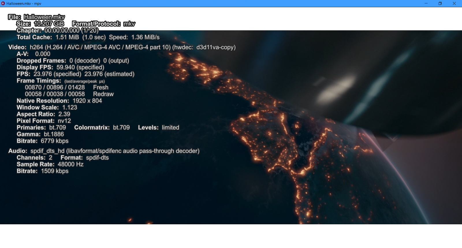

Guest asrequested Posted May 12, 2019 Posted May 12, 2019 If that doesn't work, try playing an h264 movie. Let's establish if hwdec is used.
Guest asrequested Posted May 12, 2019 Posted May 12, 2019 And probably with this config gpu-api=auto hwdec=auto hwdec-codecs=all audio-spdif=ac3,eac3,dts,dts-hd,truehd audio-exclusive=yes log-file="mpv log.txt"
Disturbd1 2 Posted May 12, 2019 Author Posted May 12, 2019 If that doesn't work, try playing an h264 movie. Let's establish if hwdec is used. Yup, it appears to be:
Disturbd1 2 Posted May 12, 2019 Author Posted May 12, 2019 Yup, it appears to be: This was also without changing the conf file. So on an h264 file with the following conf, it did show hwdec: gpu-api=auto hwdec=d3d11va-copy vo=gpu gpu-context=d3d11 hwdec-codecs=all audio-spdif=ac3,eac3,dts,dts-hd,truehd audio-exclusive=yes log-file="mpv log.txt"
