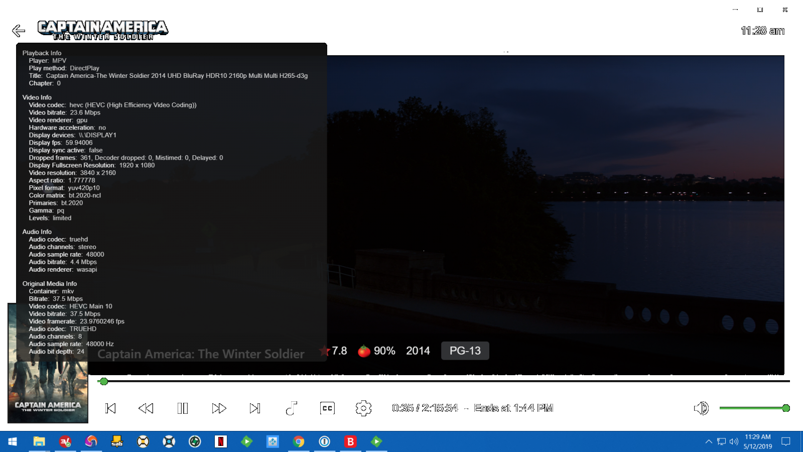

Guest asrequested Posted May 12, 2019 Posted May 12, 2019 (edited) Actually, it appears you are using the desktop app. So lets look at that. Play one of these movies and take a screenshot of the stats. You can pull them up by either pressing ctrl+j or use the gear icon in the overlay. Edited May 12, 2019 by Doofus
Guest asrequested Posted May 12, 2019 Posted May 12, 2019 And there's our answer. No hardware acceleration. What are your video settings? And what GPU do you have?

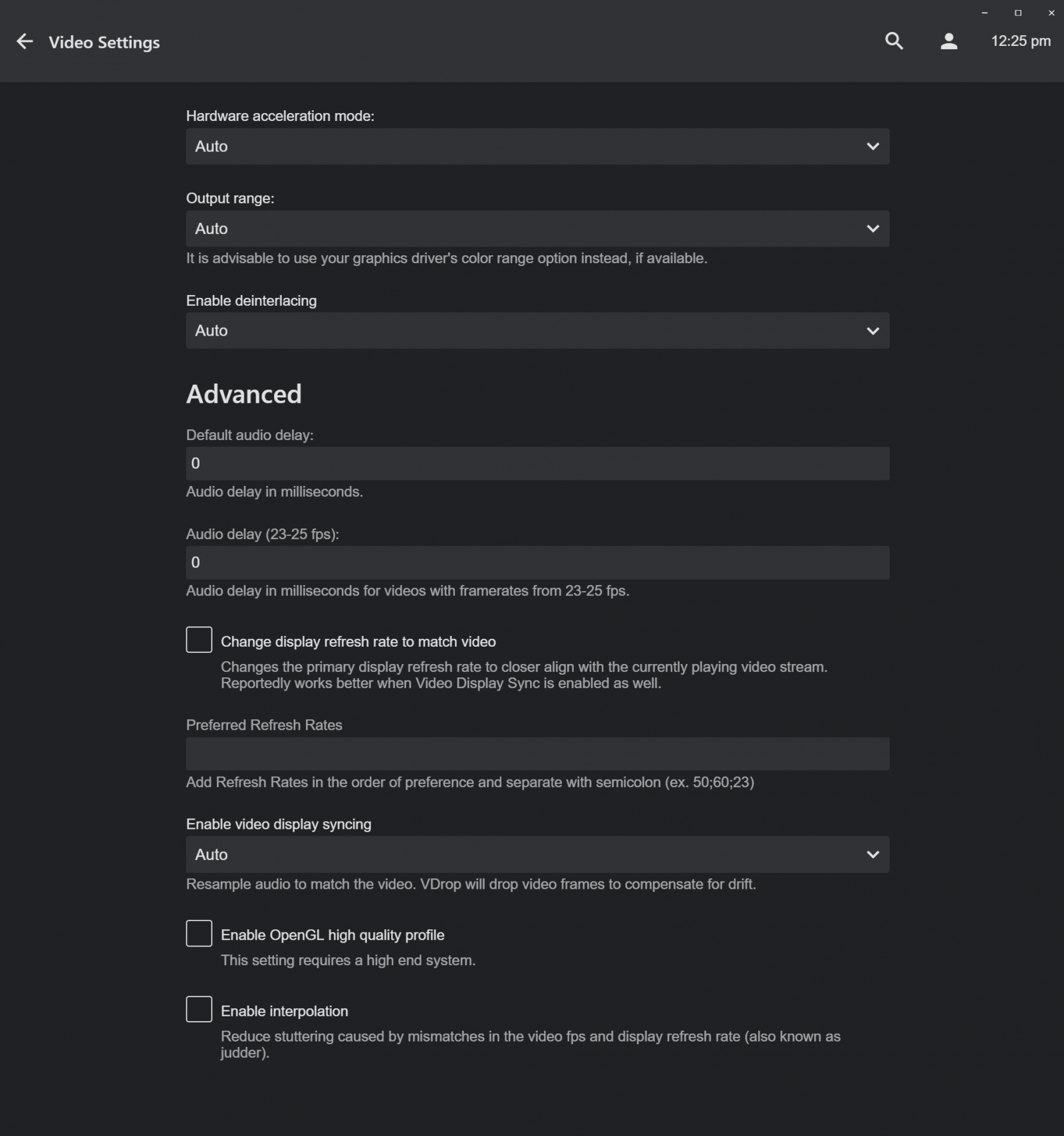

Guest asrequested Posted May 12, 2019 Posted May 12, 2019 (edited) Not sure what you mean regarding video settings. If you can tell me where to pull the info from I can do that. Top right corner, click on the user icon, then settings > video Edited May 12, 2019 by Doofus
Disturbd1 2 Posted May 12, 2019 Author Posted May 12, 2019 Top right corner, click on the user icon, then settings > video Here you go:

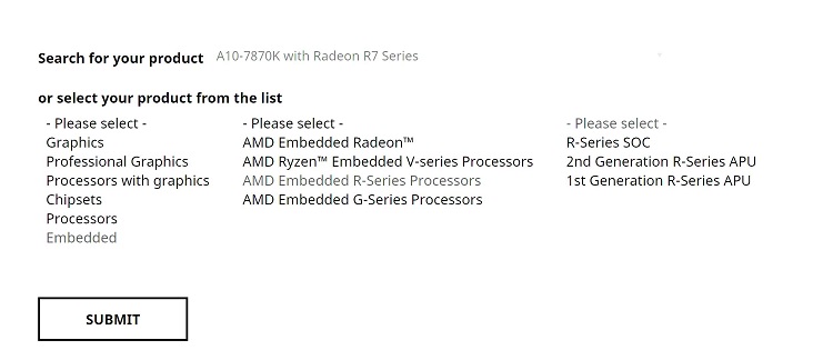

Guest asrequested Posted May 12, 2019 Posted May 12, 2019 Ok, first, do you have the latest driver? https://www.amd.com/en/support Second, try selecting D3D (Windows 8+)
Guest asrequested Posted May 12, 2019 Posted May 12, 2019 And after a quick bit of research, you may need to use copyback. So try Auto (copyback) and/or D3D (copyback)
Disturbd1 2 Posted May 12, 2019 Author Posted May 12, 2019 Latest driver installed as of this morning. Tried all 3 suggestions for hardware acceleration mode, none worked to improve. Of the 3, D3D copy back seemed the best, but the framerate is still awful. [emoji17]

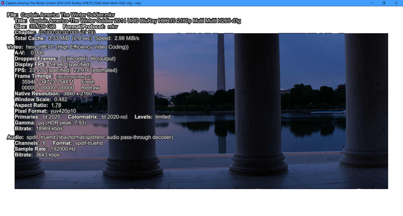

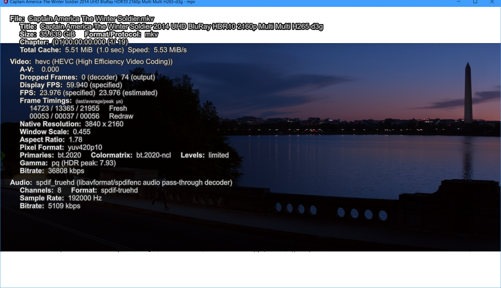

Guest asrequested Posted May 12, 2019 Posted May 12, 2019 I'm attaching a preconfigured build of mpv. Unzip the folder, anywhere. In the folder you'll see mpv.exe, double click on it, then drag 'n' drop your movie on it. It will play, automatically. To pull up the stats, press shift+i. If you can screenshot that, I'd be grateful. Also, a log file will be created in the movie folder.
Disturbd1 2 Posted May 12, 2019 Author Posted May 12, 2019 I'm attaching a preconfigured build of mpv. Unzip the folder, anywhere. In the folder you'll see mpv.exe, double click on it, then drag 'n' drop your movie on it. It will play, automatically. To pull up the stats, press shift+i. If you can screenshot that, I'd be grateful. Also, a log file will be created in the movie folder. Definitely an improvement:
Guest asrequested Posted May 12, 2019 Posted May 12, 2019 Definitely an improvement: But no hwdec. In that folder, you'll see another folder called 'portable_config'. In there you'll a text file call mpv.conf. Open that, and change the line 'gpu-api=opengl' to 'gpu-api=auto' , and try again.
Disturbd1 2 Posted May 12, 2019 Author Posted May 12, 2019 But no hwdec. In that folder, you'll see another folder called 'portable_config'. In there you'll a text file call mpv.conf. Open that, and change the line 'gpu-api=opengl' to 'gpu-api=auto' , and try again. That appears to have degraded the framerate again, playback is about as "choppy" now as when played via Emby Theater client:
