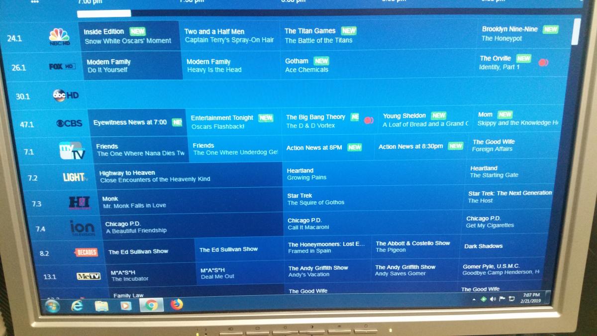

Occasionally I find that Emby has missed one or more recordings.  It doesn't happen often, and I was unsure as to why it was happening.  However, tonight it missed recording ABC World News Tonight and my local news that follows it, on the same local channel.
When I looked at the guide I saw that no program information was loaded for my local ABC channel (the one I was recording from), and there was also no guide data for the corresponding cable channel.  The specific channels are channel 30.1 (OTA) and cable channel 703 (Comcast).  My tuners are HD Homerun and I get the guide data through Schedules Direct.  I was recording both programs as series programs on OTA channel 30.1.

I should mentioned that, even after I scheduled another download of guide data from Schedules Direct, the guide data is still missing from those two channels.  I think I will need to let Schedules Direct know.  Since it's still happening they may not know about the issue.
Edit:  Hmmm, after a SECOND re-download the data is now there.  Not sure why it took two downloads to fix the problem, but the channels are back in the guide now.
