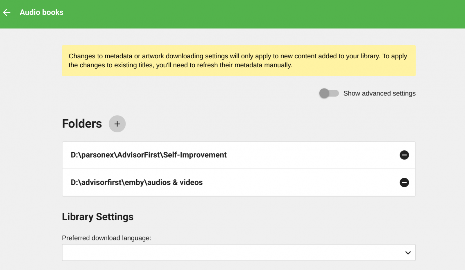

Detail4687 4 Posted February 22, 2019 Posted February 22, 2019 A few days ago I realized that my audio books (mp3) were not showing up in one of my Mixed-Content Libraries (it was working before). The folder the mp3 is in would show up, but the content would not. Strangely enough, a different Mixed-Content Library, that was pointing to a different folder, was still working correctly. After troubleshooting for a few days, and finding no solution, I decided to make a perfect-copy of the folder that was not working, and placing it into the folder structure that is working. Then, I included both folders (the original that didn't work, and copy that did) in a new Mixed-Content Library. The results stumped me: the audios showed up in one folder, but not the other! So, the only difference between the two folders are their parent folders. I think a screenshot will help...

Detail4687 4 Posted February 22, 2019 Author Posted February 22, 2019 Ok. I did that. However, I'm still having the problem that the audio files don't show up that are within the "Self-Improvement" folder (first folder below in the screenshot). But those that are in the 2nd folder do show up. Is there something that could be "wrong" with my folder that they don't show up?
Luke 42217 Posted February 22, 2019 Posted February 22, 2019 can you go over an example? is the advisorfirst or selfimprovement folder already added to some other library?
Detail4687 4 Posted February 22, 2019 Author Posted February 22, 2019 can you go over an example? is the advisorfirst or selfimprovement folder already added to some other library? Luke, I think you are correct. This morning I figured out that the folder that wasn't working was already added to another Library. I deleted that so that only one Library was scanning the folder and now it works! Sorry for all the trouble... I do have a related question... if the sub-folders contain audios books, ebooks and videos how would I add those to Emby? "Home Videos" seems to works only for video and photo "Mixed Content" only works for video and audio If I point different library-types to the same folder then I have the problem above.
