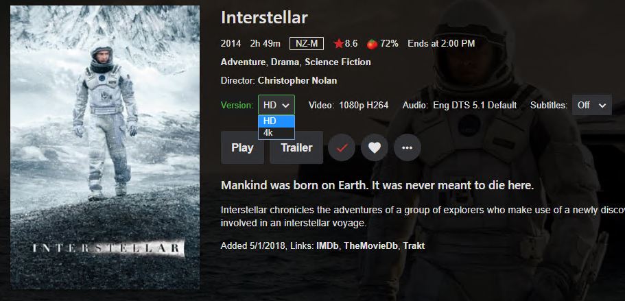

Paul77nz 8 Posted February 20, 2019 Posted February 20, 2019 (edited) I am running Emby Server 4.0.2.0 for Windows and Emby Theater 1.0.9 for LG TV. I have several movies where I have two versions of each, 1080p and 4K HDR. My TV is capable of playing 4K HDR, and previously Emby was correctly making the 4K versions the default selection, however I just noticed that it is now incorrectly making the 1080p versions the default selection. My server has only just updated to 4.0.2.0, but I can't be sure if the change behaviour coincided with the update but I suspect this is what did it. The LG app hasn't been updated for quite a while, so I believe it's a server issue. Thanks Edited February 20, 2019 by Paul77nz

Paul77nz 8 Posted February 21, 2019 Author Posted February 21, 2019 (edited) The app is out of date enough that it's not worth debugging until the update is out. If you can reproduce in another Emby app such as the web app then let's look at that. Thanks. @@Luke I can reproduce this in the Web app, Emby Theater for Xbox One X, and also when I browse the library directly on the server. The Xbox One X and LG app definitely used to select 4K by default until very recently, and I'm pretty sure 4K had always been the default selection when browsing the library directly on the server as well. Not sure about the web app as I never normally use it. The only app that it is still defaulting to the 4K versions is the iOS app on my iPhone X. Thanks EDIT: For clarity. Edited February 21, 2019 by Paul77nz

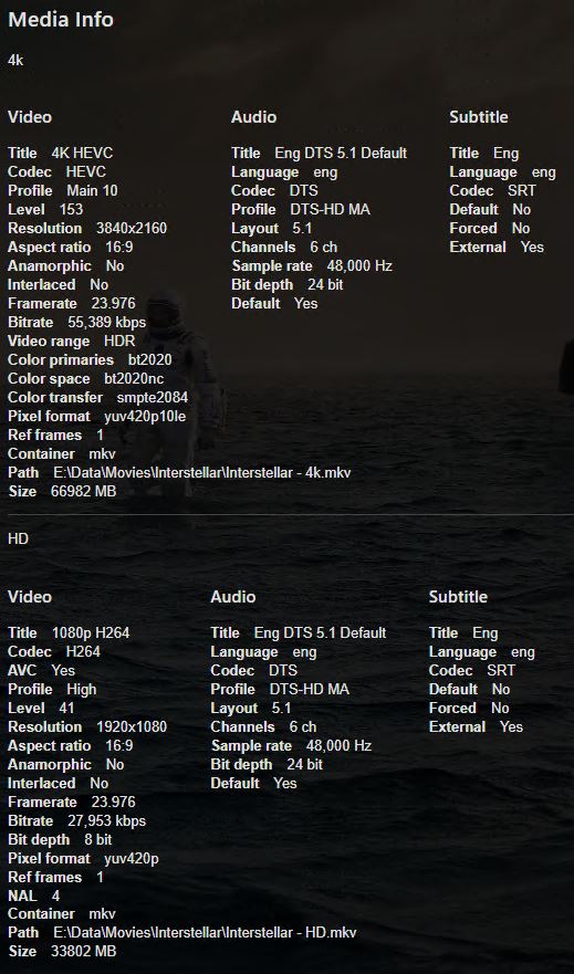

Paul77nz 8 Posted February 21, 2019 Author Posted February 21, 2019 (edited) @@cayars on the server I click my profile picture in the top right hand corner, then select "Playback". But when I browse the library on the server it puts the 1080p version first. Previously the 4K version was the default selection and at the top of the list: Media Info showing the version labelled 4k is "4K HEVC" and that the one labelled HD is "1080P H264". EDIT: Changed to more straight forward example. Edited February 21, 2019 by Paul77nz

Luke 42217 Posted February 22, 2019 Posted February 22, 2019 Remember that the feature is designed to pick the most efficient version. In your screenshot above, neither version can direct play, but the 1080p version can stream copy the h264 video, so that's why it was chosen. If the 1080p version had also been hevc, then i believe it would have selected the 4k version.
Paul77nz 8 Posted February 22, 2019 Author Posted February 22, 2019 (edited) Remember that the feature is designed to pick the most efficient version. In your screenshot above, neither version can direct play, but the 1080p version can stream copy the h264 video, so that's why it was chosen. If the 1080p version had also been hevc, then i believe it would have selected the 4k version. @@Luke I thought the web app was direct playing both files, but you're right it is actually transcoding. LG app definitely direct plays both versions, but does that leave me waiting until the new LG app is finally approved before it can be looked into further? Can you advise if the new LG app waiting for approval has it's own setting for quality? What's annoying is that the LG app hasn't changed, and I have demonstrated that the change in behaviour is a result of upgrading the server to version 4. Perhaps this new behaviour is correct for the web app, but it unfortunately messes up the LG app! I'm still working on the assumption that the LG app chooses it's default version based on the Web App - but is this actually they case? If so, is there a way I can force the Web App to pick the default version based on something other than the codec or resolution? Alphabetically would be fine, but is that possible?Thanks If all else fails, is there a way I can prevent server updates so I can restore to 3.5.3 and keep it at that level until LG finally approve the new app? I found the setting to prevent auto server updates, so if all else fails it might be a temporary option to revert to 3.5.3. @@cayars when you tested in the beta that is defaulting to 4K version, can you advise what the video and audio codecs of the 4k and 1080p files are? Thanks Edited February 22, 2019 by Paul77nz
