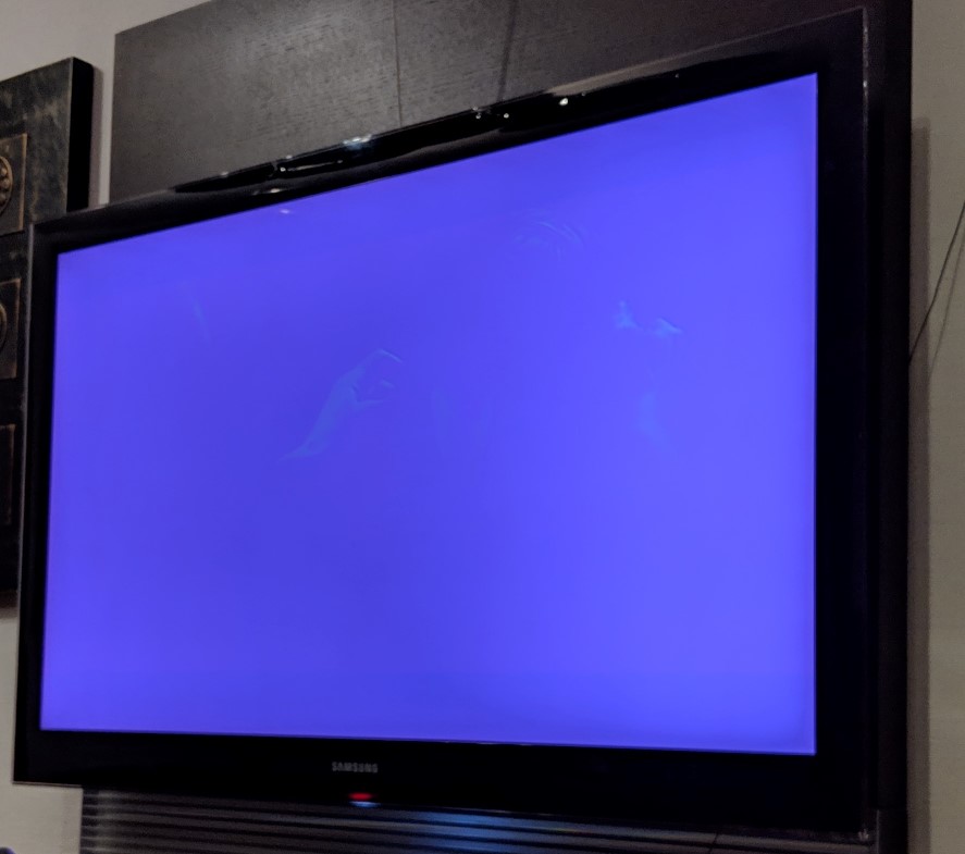

jpb1977 0 Posted February 21, 2019 Author Posted February 21, 2019 Here is an example. Although in the picture it's blue/purple when in real life its more fucia/magenta-ish. Also the opacity varies depending on source scene. I am running latest version of Emby on both Windows and Linux. please see attached logs. embyserver-63686217599.txt ffmpeg-transcode-2d2cd531-8b1d-4471-a468-e14b6aee06ff_1.txt ffmpeg-transcode-258acd67-9124-461e-81ba-028c4f720348_1.txt
