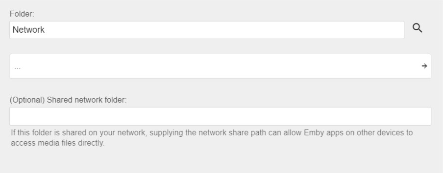

mbguy 40 Posted February 19, 2019 Posted February 19, 2019 (edited) When browsing to a network folder, it shows "..." instead of network shares. What's really annoying is, all previous paths saved using network shares like this are no longer updating its changes during library scan. What does this feature keep breaking every few cycles? It broke before but it was fixed a while later. Is this going to take a long time to fix again? Should I change all my Folder paths to local folders instead of network shares? Edited February 22, 2019 by mbguy
Luke 42217 Posted February 19, 2019 Posted February 19, 2019 Seems to be fine here in my testing. You can always enter the path manually. @@softworkz

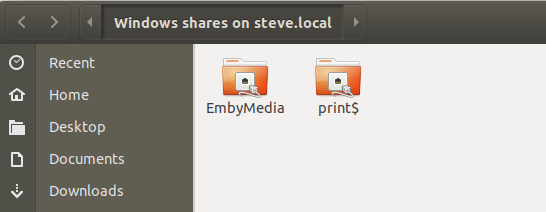

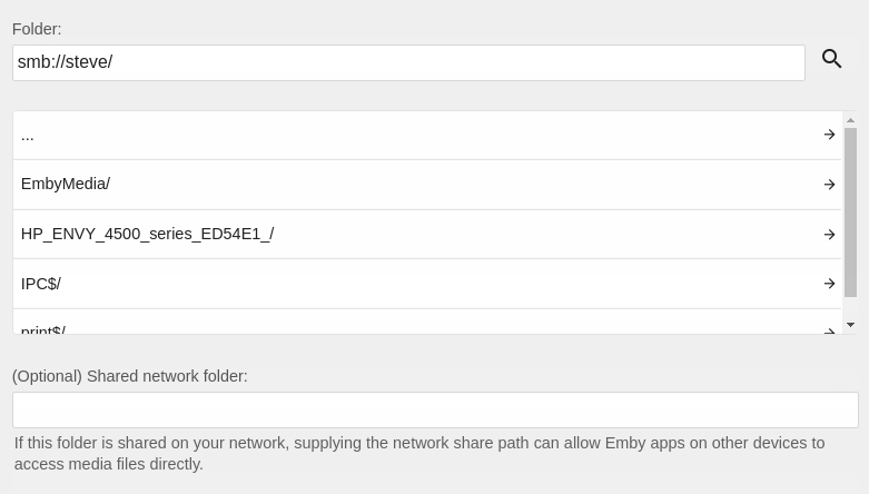

EODCrafter 181 Posted February 21, 2019 Posted February 21, 2019 (edited) I tried entering the network path manually, but library scan wouldn't pick up changes. The only way I was able to get Emby to detect the changes were to change the path to local path D:\movies I had none of these issues for many versions of Emby until 4.02. Sometimes Giving smb://sharename will show your shares. But this is working fine here. Edited February 21, 2019 by EODCrafter

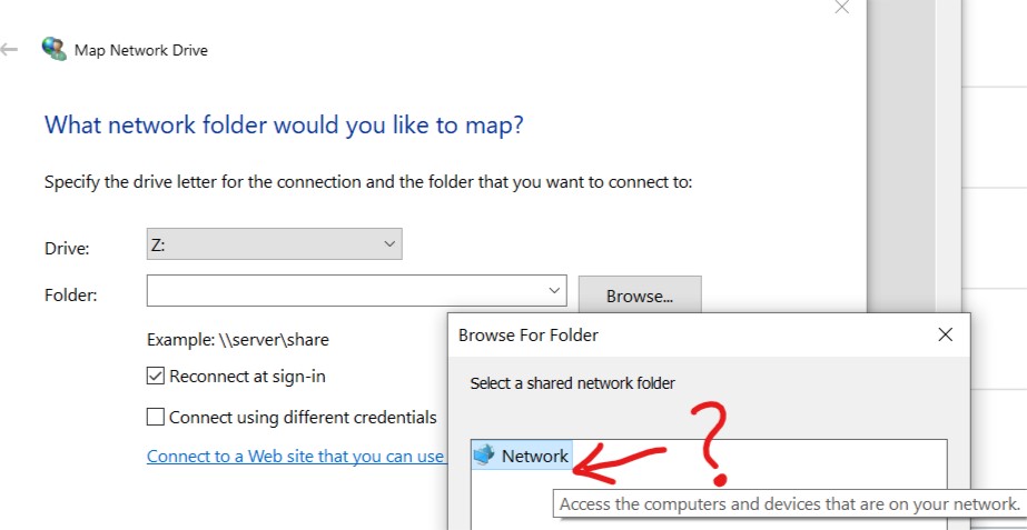

mbguy 40 Posted February 22, 2019 Author Posted February 22, 2019 Thanks for the clarifcation everyone, from now on, I will map network drives to local folders. I know this is not a Windows 10 forum, but any Windows users here who have experienced a similar problem? When I go to Network shares? The list of shared folders are not coming up? I suspect some networking settings are broken on my Windows 10.

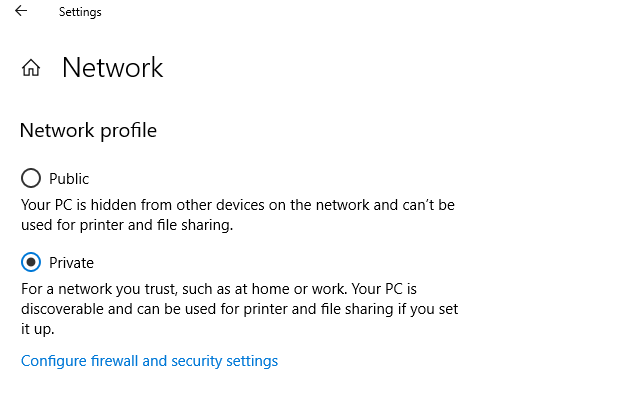

EODCrafter 181 Posted February 22, 2019 Posted February 22, 2019 (edited) Thanks for the clarifcation everyone, from now on, I will map network drives to local folders. I know this is not a Windows 10 forum, but any Windows users here who have experienced a similar problem? When I go to Network shares? The list of shared folders are not coming up? I suspect some networking settings are broken on my Windows 10. Looks like you haven't shared any folders yet or your Network is firewalled from any outside connections. Edited February 22, 2019 by EODCrafter 1
mbguy 40 Posted February 22, 2019 Author Posted February 22, 2019 Not sure what I did, rebooted the machine, now I can see all the network drives. Another strange thing is now happening, I have successfully mapped a shared drive to Z: and I can browse successfully using Windows Explorer, but when I attempt to add this folder in Emby I don't see the mapped drive Z: Why is this happening and what else can I do?
