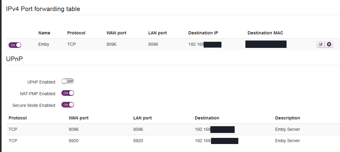

crusher11 1138 Posted February 14, 2019 Author Posted February 14, 2019 It's very difficult to diagnose without knowing a lot more about your Internet connection and LAN. What we know; - You can't connect to Emby nor Plex from outside your LAN. - You don't think you're using a NPN or reverse proxy. - You entered some port forwarding numbers in your router. Can you show a screen shot of your port forwarding info? Crop out the last 3-6 digits of your IP address, for privacy. What is the router make/model? It's an ISP-branded router from MyRepublic. Port forwarding and UPnP attached.
EODCrafter 181 Posted February 14, 2019 Posted February 14, 2019 (edited) It's an ISP-branded router from MyRepublic. Port forwarding and UPnP attached. LOL, We can't "connect" to your Local IPs, no use in blacking those out ...IE 192.168.1.105. Is that what your trying to connect to as external? Google "whatsmyip" and put that Number in a browser followed by :8096 and see what happens...P.S. Don't share that number! What's that *Secure Mode in the Router? Is that essentially a router firewall blocking weird things like Emby perhaps? Edited February 14, 2019 by EODCrafter

crusher11 1138 Posted February 14, 2019 Author Posted February 14, 2019 LOL, We can't "connect" to your Local IPs, no use in blacking those out ...IE 192.168.1.105. Is that what your trying to connect to as external? Google "whatsmyip" and put that Number in a browser followed by :8096 and see what happens...P.S. Don't share that number! What's that *Secure Mode in the Router? Is that essentially a router firewall blocking weird things like Emby perhaps? The whatsmyip IP is the one listed in the Dashboard as my WAN address, that's why I've been trying to connect to. Is that what I should be forwarding the port to? Or do I have that correct? No idea what secure mode is. I see a thread on the Plex forum where someone is explaining why MyRepublic customers have this problem. Does your Remote (WAN) IP start with 100.? ie: 100.123.234.### You can see your Remote (WAN) main screen of the Emby Dashboard. You may have to pay for a static IP from MyRepublic. It starts with 103.
Angus Black 5 Posted February 14, 2019 Posted February 14, 2019 LOL, We can't "connect" to your Local IPs, no use in blacking those out . I asked him to block out the IP just in case he was using his WAN IP rather than a LAN IP. All we need to see is the 192.168. anyway.
crusher11 1138 Posted February 14, 2019 Author Posted February 14, 2019 I asked him to block out the IP just in case he was using his WAN IP rather than a LAN IP. All we need to see is the 192.168. anyway. Did you miss my last post? We may have posted at the same time.
