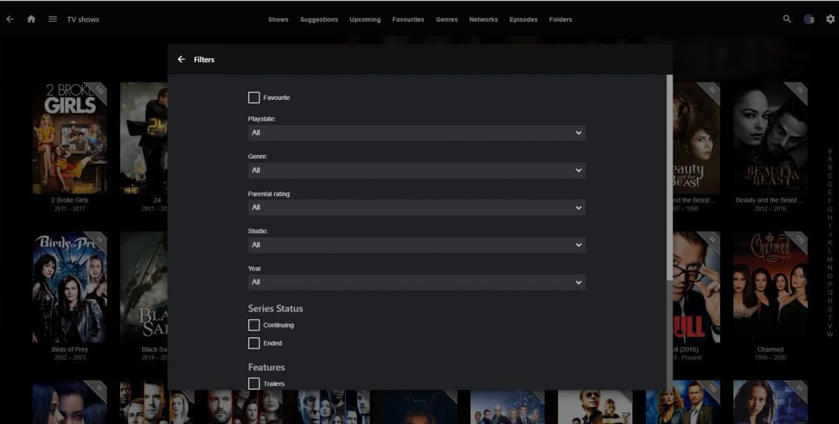

FreakUK 0 Posted February 12, 2019 Posted February 12, 2019 Hi all. I've run in to a bit of an issue. When browsing TV shows on the server, all of the filters work, EXCEPT the Series Status one - If I opt to only show "ended" series, nothing shows. Same if I choose to show only "ongoing" series. I've tested all other filters (studio, rating, year, etc), and they work exactly as expected. Is this a known issue, or is it likely to be something wrong with my install? Server is running on Debian, if that makes a difference. (Screenshot 1: No filters applied. ~ Screenshot 2: Status filter applied)

FreakUK 0 Posted February 12, 2019 Author Posted February 12, 2019 (edited) In my testing it seems to be working here. Have you checked to see that your series are tagged with this information? That is likely the issue. The relevant series are marked as ended within the metadata, and I've also tried manually "tagging" them with an Ended tag, just for completeness, yet I'm still having the issue :/ Like I mentioned above, it's not a "world ending" issue, it's just more of an annoyance than anything else I am not seeing any issue in stable or beta with filtering Ended Series. So it's likely a local issue then, rather than a software one? Joy oh joy... Edit: Add screenshot Edited February 12, 2019 by FreakUK
Luke 42242 Posted February 12, 2019 Posted February 12, 2019 Yea that's very strange. You're on the series tab there, right?
FreakUK 0 Posted February 12, 2019 Author Posted February 12, 2019 Yep. Definitely on the TV Series > Shows tab. Strangely, I just tried it on a windows machine, and the filter is working fine for both "ended" and "continuing", so it would seem to be an issue with the debian version - again, whether it's just a local error or not, I'm not sure - I'll have to try installing it on a different Linux machine tomorrow, and see if it works there. If it works on a different Linux machine, I'll try a reinstall on my server. Or, if I decide I'm too lazy for that, I'll just wait til I rebuild the server in a couple of months
