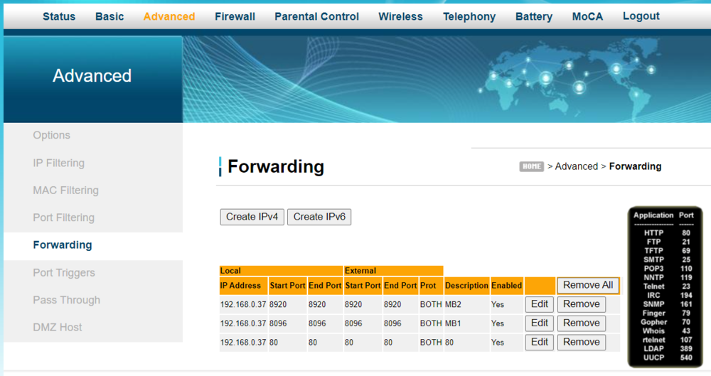

Carlo 4561 Posted May 1, 2021 Posted May 1, 2021 Take a screen capture of your port forwarding setup in the router and post that here for us to look at. What is the local IP of the laptop running Emby Server.

Rei 0 Posted May 1, 2021 Posted May 1, 2021 I'm sure this is due to my missing something/lack of knowledge, so I really appreciate the help. This is my port forwarding setup: The laptop's IP is 192.168.0.37.
Carlo 4561 Posted May 1, 2021 Posted May 1, 2021 That looks ok. Do you only have one router in total or do you happen to have multiple routers? If you open a command prompt on a PC in your network and type tracert 8.8.8.8 Does the 2nd to 4th result start with 192.172. or 10. ?
